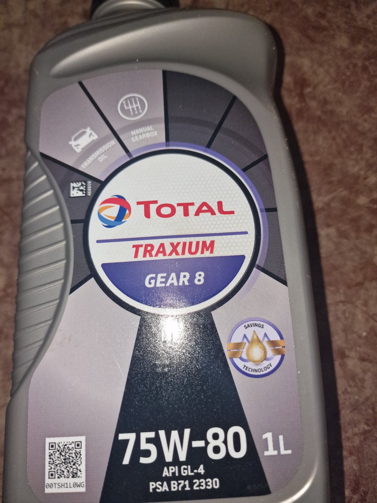

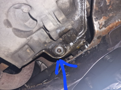

Peugeot service charges you for Hello 10$ here, update, oil change in gearbox was fast and easy.
Remove draining bolt and drain old oil.
Then remove intake tube and open cap so it drains completly.
Put in new oil, total gear8 75w80, 1.9 lit.

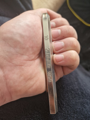

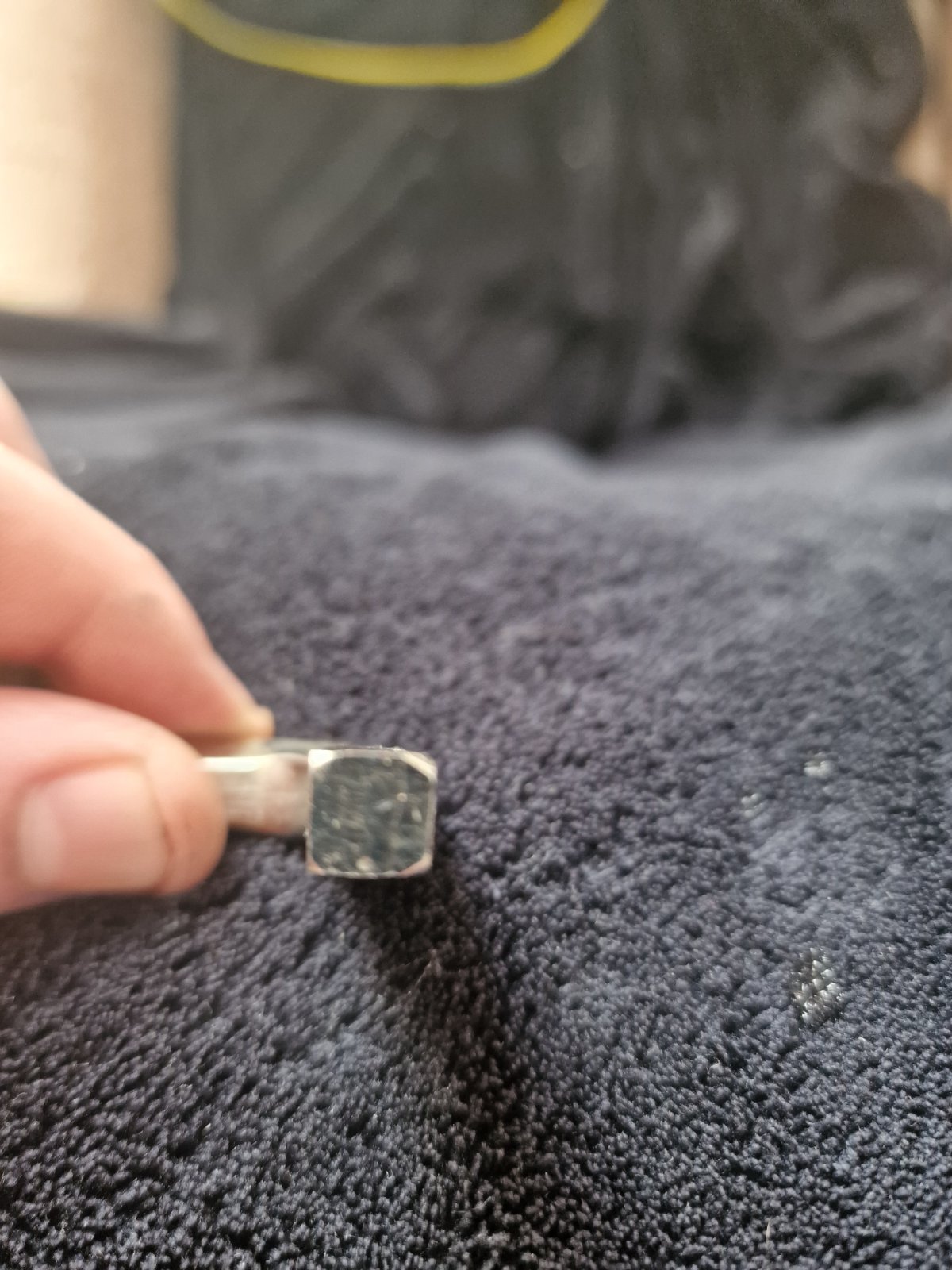

You need special tool for screw on bottom it is 7mm or 8mm square, i made it from unior hex key 10mm, just ued angle grinder till it fits.
