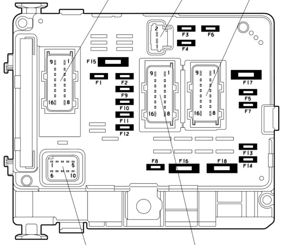

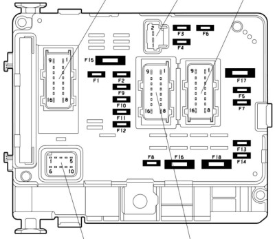

Please help. Engine cooling fan not turn on.
Checked every cable and fuse (in and out under the engine hood)
Changed 3 relay to new
Changed 2 resistor to new
Changed the fan motor to new
The cooling fan still not working.
What should I do?
I switched on the AC, the fan not turn on
I plugged out the temperature sensor, the fan not start.

I tried everiting and the fan not working
is that possible the bsi cut out the fan controlling outpot?

As I think you know, you should find the signal wires from the ECU that run the fan. These probably are active low, that is connecting to ground runs the fan. You might be able to short the ECU pin(s) to ground to do this, but is much safer to find where to disconnect from the ECU. Then without the ECU being involved, connect the wires to ground and get the fans to be controlled like that. Once they work purely as fans, go on to fault finding the ECU if necessary.
You may find diagrams on line. I doubt if there will be much functional difference between Citroen cars of about the same vintage, but unfortunately fuse boxes and wiring do differ in detail between models.
