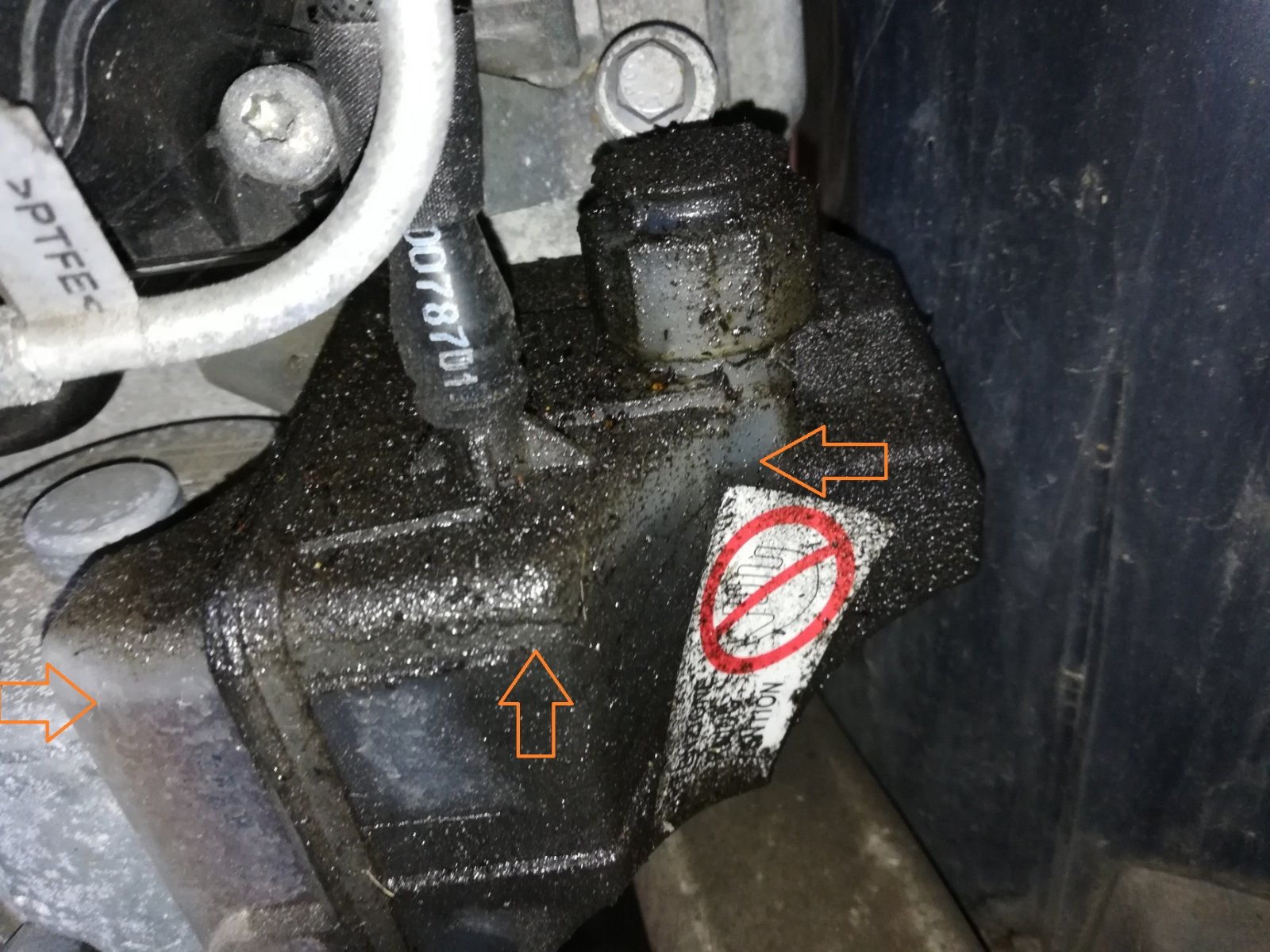

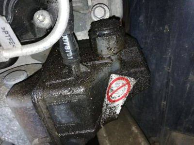

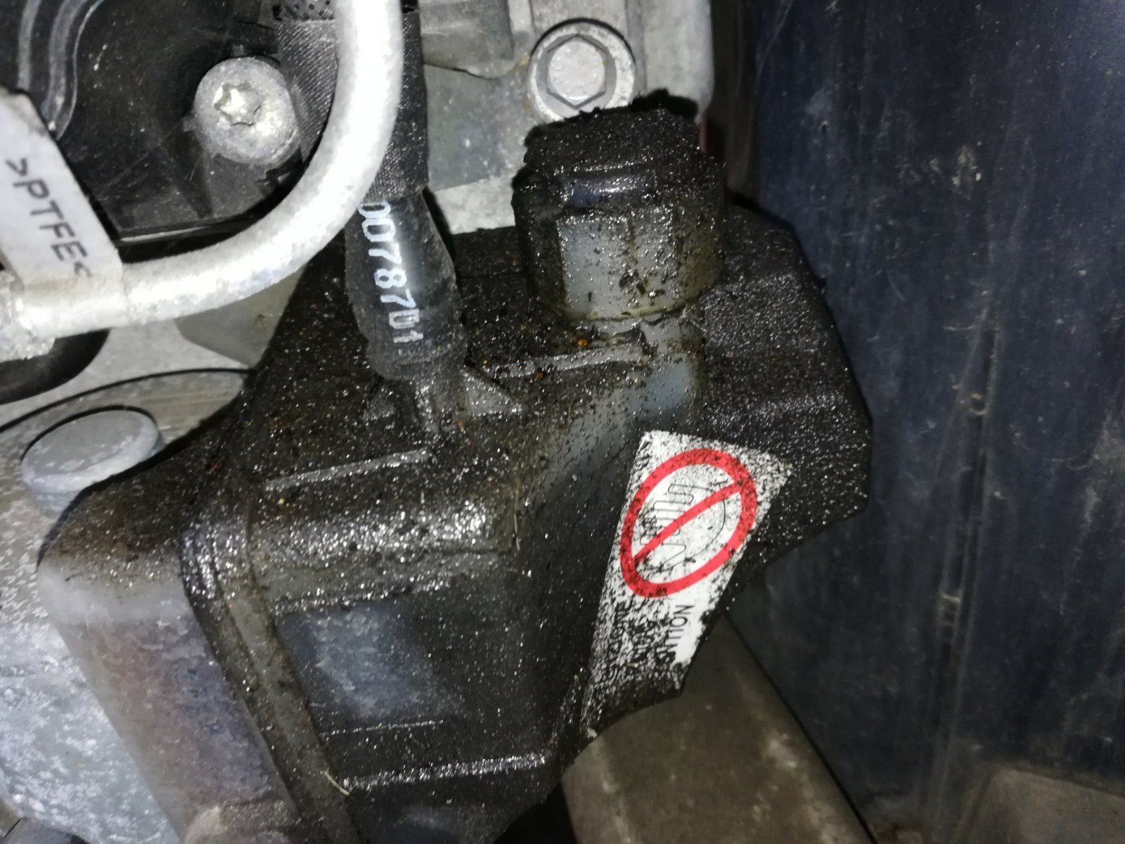

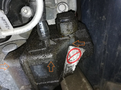

Just looking under the bonnet, honestly looking properly for the first time in years I must admit. Saw the top of the undertray looks sticky, pretty sure I've traced it back to the top of the gearbox actuator (it's the 6-speed ETG robotised gearbox). Here's a photo of the thing...
It looks like it's definitely been leaking for a long time from the look of all the muck that's stuck to it. Here's a listing for a sample of what looks like a similar unit, showing what it should look like (it should be white!)...
https://www.ebay.co.uk/itm/255591694841
I managed to tip the camera upwards, all looks dry above it...
My knowledge is pretty near zero. I'm guessing that this is some kind of hydraulic fluid, possibly leaking from the rubber hose although it's hard to tell. Is that bigger round lump next to the hose some kind of automatic air vent? I'm assuming that spewing goo out is not expected behaviour!
It's going in the garage for an oil change soon anyway, I'm going to ask them to have a look. Just wanting to get ideas of likely causes and cures beforehand, and hopefully avoid paying Citroen a grand or so.
All ideas appreciated!

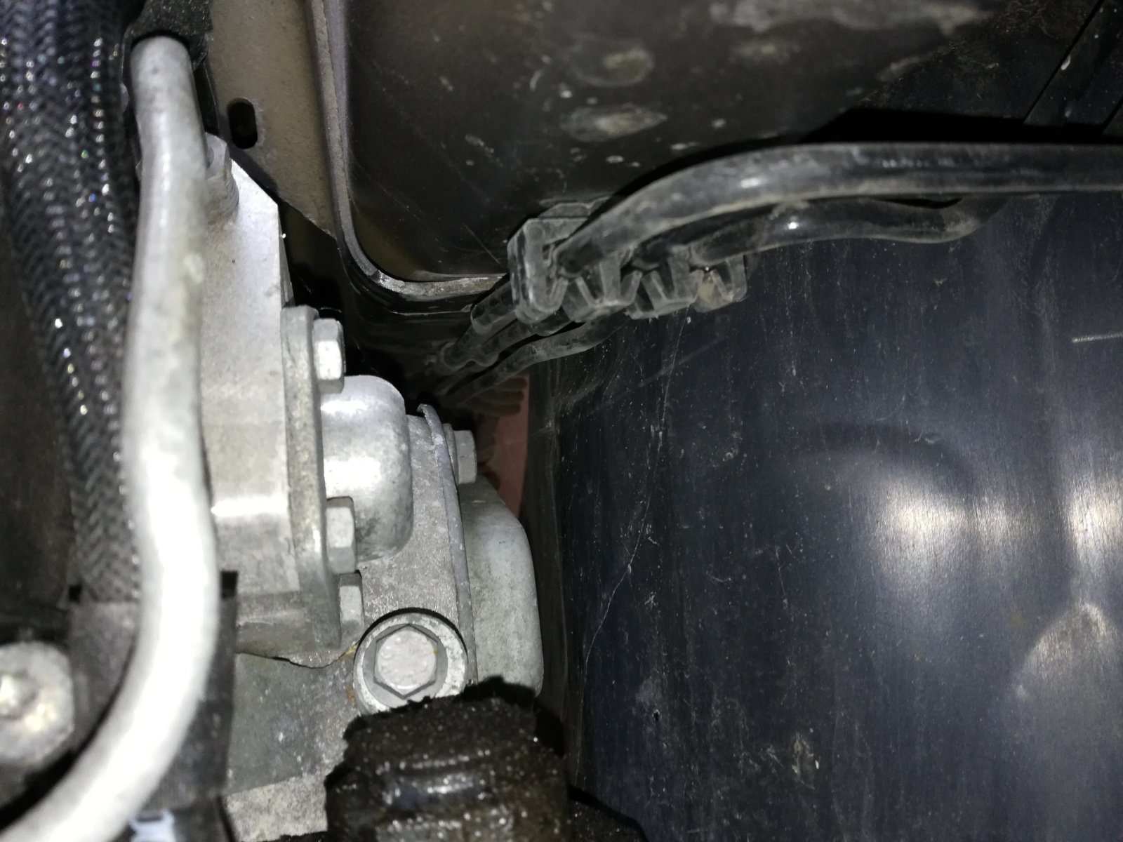

Looking at what I'm calling the air vent, I don't think it would be gooey if the hose was leaking, as it wouldn't run uphill up it. So that vent must be the culprit.
Could this be as simple as just unscrewing the old one and fitting a new one? Depending on whether it's pressurised when not running. I'm assuming some fluid somewhere will need a change or top up too.

Looking through the grot in my original photo, it looks to me like the fluid level may be as shown by the orange arrows I've added...
If so then is it possible that there's nothing wrong with it and it was just overfilled when new? Alternatively is it possible that some other nasty failure is causing there to be an apparent excess of fluid?

Be very careful, the actuators are pressurised and checking the hydraulic oil on this is done with the system first depressurised! After it has been depressurised using diagbox, then the oil level can be checked and filled to within the marks if required. Then the system is re-pressurised, again using the diagnostic tool.

Well I put it in the garage for the oil change, asked them to clean up the spill and have a look.
I was quite pleased to hear him (unprompted) suggest my theory that it was just too full from new. It's still on the max line.
I bought the replacement cap though. I swapped it myself, after jacking up, removing the wheel and wheelarch liner.
I can confirm that the header tank is just ambient pressure, just a little hiss like a bottle of pop when I opened it perhaps half an hour after running it. The original one wasn't very tight, this may have been the issue - perhaps it was sealed unless cold and/or was being lobbed around a corner. It's now as tight as a hand can turn a bottle top, I don't know how many Nm that is but I'm happy it's sealed.
So... it's all nice and clean now, so at least I can see if it leaks again. For all I know that mess might have happened years ago and never again since.
The top does have a vent hole sticking out of the side of its top, but it's hard to make sense of really. It looks like the rubber washer inside it seals it completely, but it may have some kind of hidden magic hole or slot within it that I couldn't see, it's a weird shape, kind of like a bowler hat.
