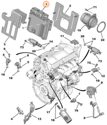

hi can you help me with ecu part number for this
vin number is VF3**************[VIN obfuscated, can be read by forum staff]
and if the is equivalent numbers that will go with this model

@malawiboy1 : Which ECU are you talking about? Engine ECU, BSI, ESP / ABS ECU, there are at least 20 ECUs on the vehicle.
For now, I'll assume you mean the Engine ECU
Item (1), Part: 1608291280, price £1413.36 inc. VAT from Citroen, brand new. This is the only PSA part number for your vehicle.

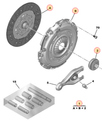

Hi Ya,
Would it be possible to get the part number and if possible the engine code and transmission type for the following parts please:
Vehicle C4 Picasso 2014 1.6 Hdi
Parts:
Clutch
Rear Pads & Disc
Timing & Auxiliary Belts
Man Thanks
Zane
Parts:
Clutch
Rear Pads & Disc
Man Thanks
Zane

Already have it Richard
@zane2g2: (If this is for your VIN ending 017):
Clutch Kit
Item (1) OEM New Clutch Part: 1610211580, £553.13
OEM Exchange Clutch Kit, Part: 1610212980, £289.90
Rear Brakes
Discs
Item (1)
OEM Disc kit, Part: 1609582880, £116.82
Pads
Item (2)
OEM Pads, Part: 1636413980, £95.93
OEM Cheaper Pads, Part: 1619790880, £63.49
Timing
You have several options:
OEM Belt only item (5), Part: 1608745980, £124.48
OEM Original Timing Kit Item (6) that includes the Belt and the tensioning and retractor rollers (3) & (4), Part: 1608747480, £171.02
Or as above, but cheaper kit alternative, Part: 1635067180, £115.45
Or
Full OEM Kit that includes the belt, tensioning rollers and the water pump Item (15) Part: 1613561980, £254.88
Cheaper Full Kit, Part: 1684891780, £163.64

thanks youGiveMeABreak wrote: ↑27 Jun 2022, 21:51 @malawiboy1 : Which ECU are you talking about? Engine ECU, BSI, ESP / ABS ECU, there are at least 20 ECUs on the vehicle.
the engine ECU
the one you have got but is other equivalent numbers that will work on the same model?

That’s the official part number for this engine ECU. Each ECU is designed for a specific engine.
You can search on this number and as long as this number is returned in the results and you have checked with the seller that the number I provided is compatible, you should have the correct one.
