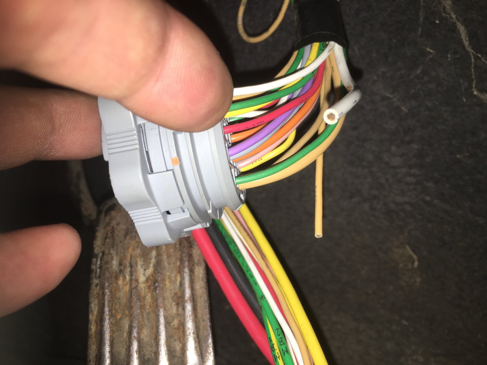

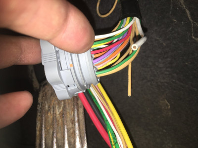

Attached is a photo of the grey round and for the sake of future searches, circular connector in the front footwell behind the BSI. The two wires I described as disconnected may have fried after a long period of corrosion when reconnecting the battery recently, but still look to be clean cut with no heat damage. If I knew what they were for that would be brilliant. I've tried every wire to the instrument panel connector but none of them show a current. I've also tried the checking continuity on the VAN lines but I should think I would have more success with everything reconnected and testing between HI/LOW to find the differences.
Just for reference to the photo you can see a beige wire loop on the black connector at the top of the photo.
There's a black and a grey connector and from the looks of them no VAN lines on either. The black one is fully connected so not worrying about that.
More to come and I'm bound to get boring after a while but promise to post a solution if one is found.

OK the 'cut' wires may be spare repair wires, many PSA vehicles have these, there can be up to 4 of them 4? you should be able ti ID the wires if you can see the codes prinded on the sleeving. If this is what it is the other end of them can be found underneath the under bonnet fusebox. If they are damaged wires you would see a terminal in the connector with no wire attached to it.

Thanks Wheeler, I'll squeeze in and see if I can get some codes. I was trying to read them but gave up when my elbows got scuffed and pains started again in my lower back - had to delay working on the trailing arm bushes of the focus for almost two months until recovered last time, so being careful. I've not had much luck with cars since September last year. I've done a good job fixing them, but getting there has been painful.
Spare wires they could be but as for a lone connector - some of them have two or even three wires connected, so it might have broken from one of those, there is one with a beige wire which looks a little loose but I'll follow your sound advice and check the codes and compare at the other end.
