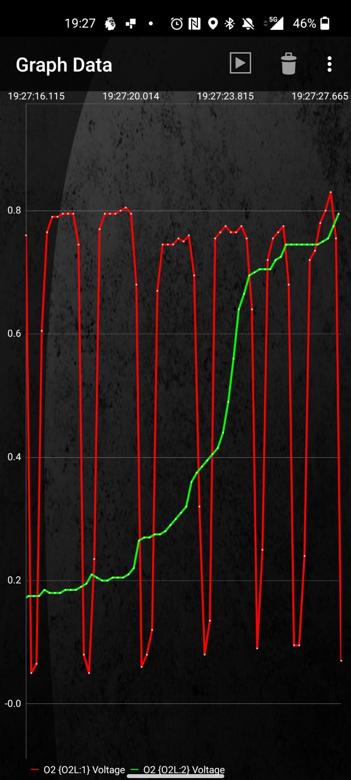

All of the above is exactly what I’d expect to see from a perfectly working system.utdminiman wrote: ↑15 Jun 2022, 11:38
Diag is showing closed loop and once warmed up post cat o2 is flat anywhere from sometimes stays flat showing rich sometimes showing lean, depends if I've just driven it about. Pre cat o2 (the one flagging the codes) seems fine and fluctuating from about 0.1 to 0.7/0.8v although it does seem a bit erratic.

So, took it for a test run, annoyingly couldn't replicate the issue but grabbed some o2 readings anyway, all the screenshots are closed loop reading - I've added a bit of a description to each image for the conditions
The engine is running rich and using more fuel than usual which is part of the reason for replacing the sensor. I was getting around 45mpg with mixed driving (50+ if I'm doing 70 on a motorway stretch) and getting roughly 400-450 miles out of a tank before needing to think about filling up. Now I'm getting 39mpg according to the car and usually the fuel light is coming on at around 325-350 miles which given the price of fuel atm is a bit of a stinker.

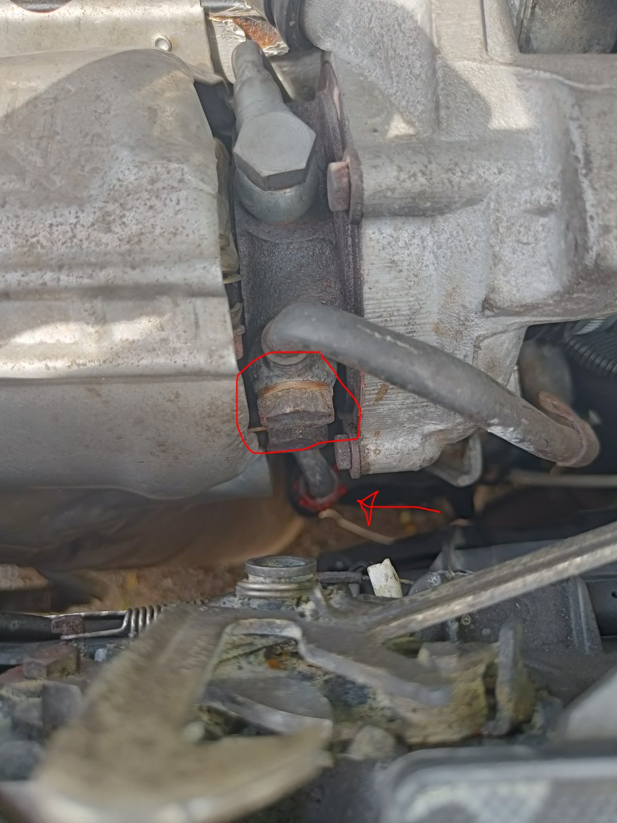

Right so intermittent beeping is back, was on the driveway idling and the light would come and go every 30 seconds or so (link to video: Got the o2 readings up, them seemed fine as above even when the car beeped and when they EML turned off steady fluctuations and steady post cat o2. Idle revs have jumped to 1k revs though, normally idle at around 700rpm which is strange.
Opened the bonnet and it was hot under there, like opening the oven hot, admittedly it's just been driven for 20 mins and its a hot day and a black car but I've opened up the bonnet before and it's not been that hot. Engine it's self seems fine coolant temp reading 80-100 during use, but I've noticed a slight coolant leak and a very slight hissing on the turbo see picture circled, it appears to be coming from the banjo also circled. Is there a chance the coolant leak is causing the turbo to overheat massively which is pushing the o2 sensor near it's upper limit of capability flagging a code and making it go away?
