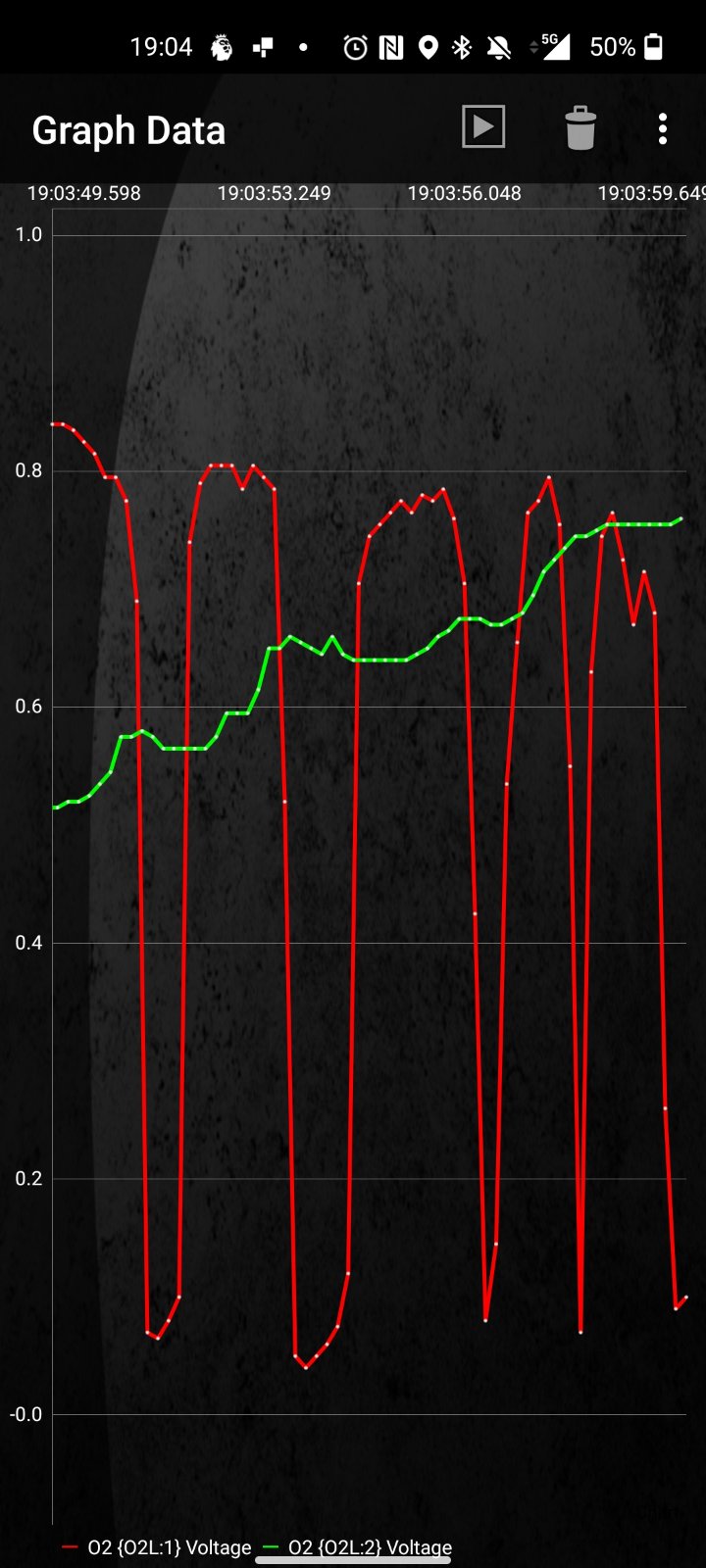

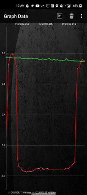

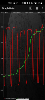

So, took it for a test run, annoyingly couldn't replicate the issue but grabbed some o2 readings anyway, all the screenshots are closed loop reading - I've added a bit of a description to each image for the conditions
The engine is running rich and using more fuel than usual which is part of the reason for replacing the sensor. I was getting around 45mpg with mixed driving (50+ if I'm doing 70 on a motorway stretch) and getting roughly 400-450 miles out of a tank before needing to think about filling up. Now I'm getting 39mpg according to the car and usually the fuel light is coming on at around 325-350 miles which given the price of fuel atm is a bit of a stinker.
As I mentioned the cars had a lot of bits and bobs done to it over the last year / 1.5 years, detailed below from oldest to newest (the first 5 were all done at the same when the engine when completely dead)
New timing chain and accessories, inc head skim new gaskets etc
New thermostat
New clutch, reluctor ring, crankshaft sensor
New camshaft sensor
New MAP and boost pressure sensor
New High pressure fuel pump
Walnut blasting the inlet valves
Spark plugs and coil packs
Basically it seems annoying it's had all that work poured into it over the last year and now I'm getting crappy mileage out of it. The car runs fine although does seem a tad sluggish but I'm guessing that's down to the excess fuel being used by the car. Any ideas would be great because I'm all out for now!
New thermostat
New camshaft sensor
