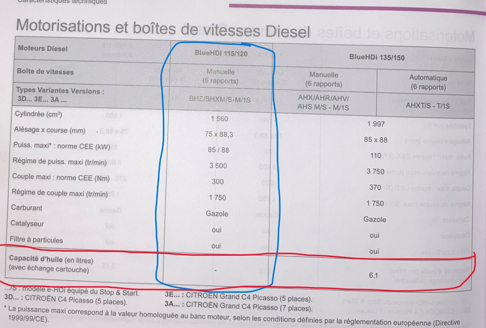

Out of curiousity, while not a PN request, would you be able to confirm a basic spec for me from the Citroen manual? I need to confirm the official engine oil capacity. From filling manually, I believe that it's 3.75 liters but the manual doesn't say and my Haynes/RTA manual says 5.5 liters (with filter). I'd like to have something "official" when I reach out to Haynes/RTA.
First pic is what the manual shows (my motor in blue and oil capacity in red). All previous pages show 11 different types of motors, all with 3.75 liters. Only the page with my motor shows nothing.

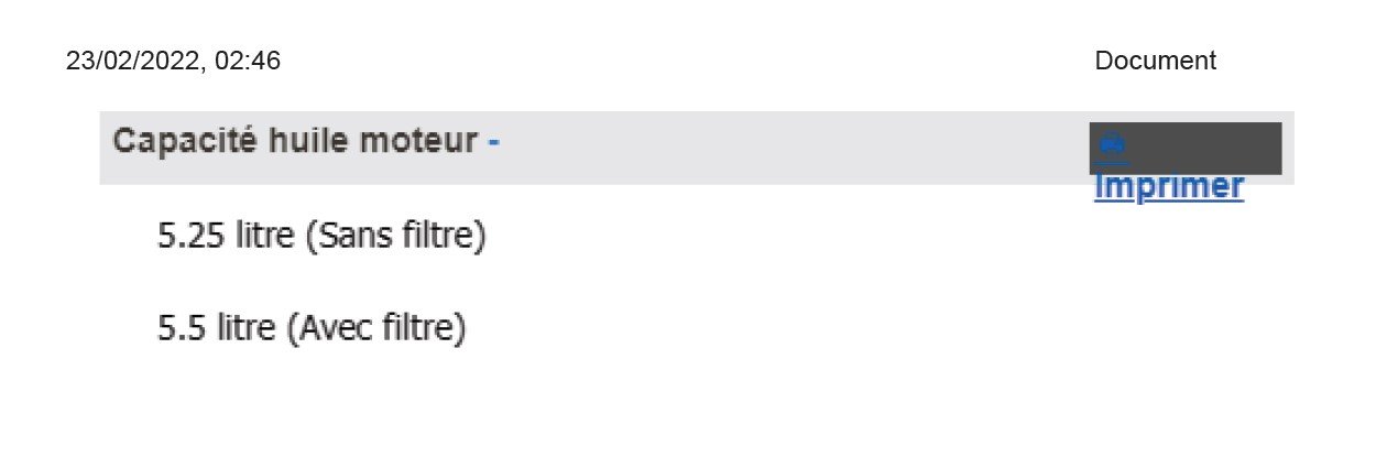

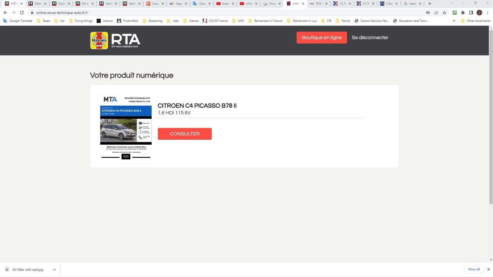

Second page is cover for my online Haynes/RTA manual/MTA.

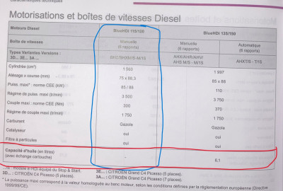

Third page is what that manual shows for engine oil capacity, with and without new filter.
