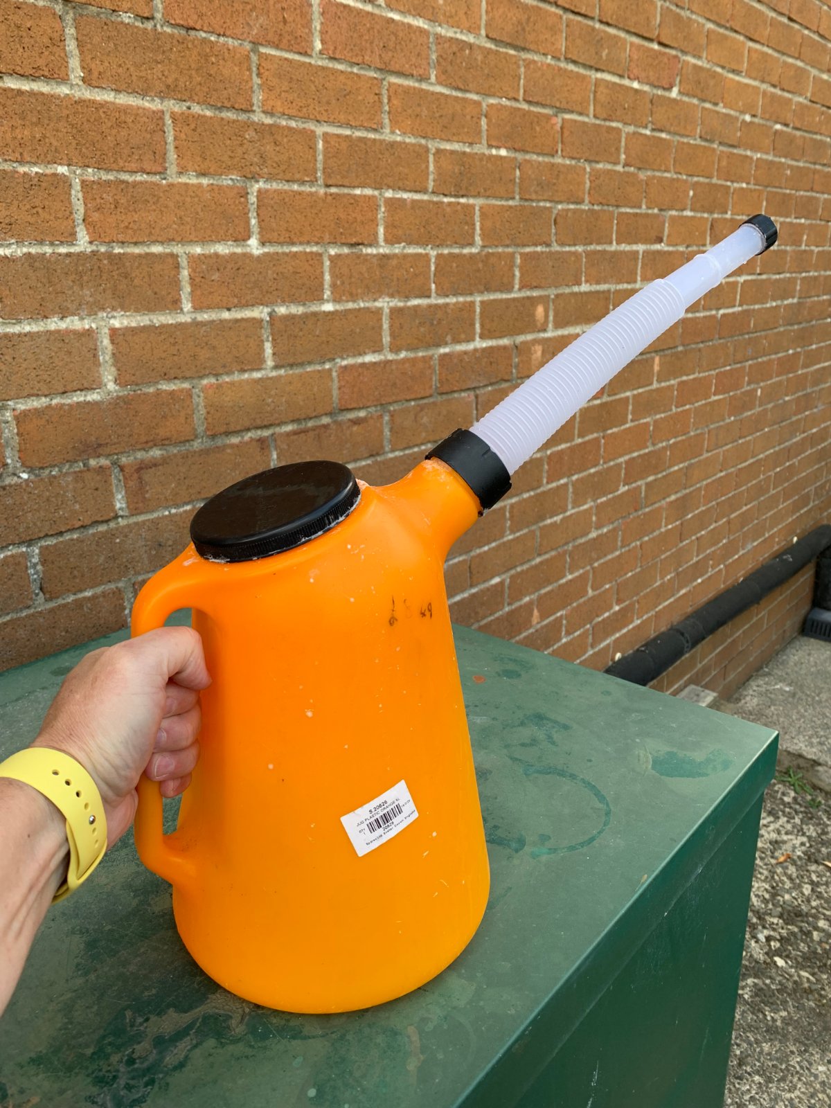

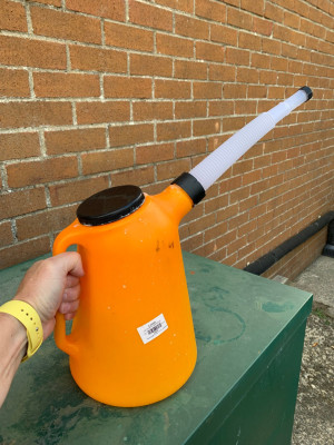

Ok so do be careful as there is a sort of mechanism that seems to open as the spout is introduced.
Trying to fill from a 10L bottle is not a good idea on account of trying to guide the tube in and balancing a 10 Litre container of heavy plastic with the other hand - it's all bound to end badly and 'UREA on your chips'.
This is what I bought and it works perfectly for pouring from the large container into the wide top part of the vessel and from there I can easily top the tank up in one or two goes.
I bought it from a hardware / agri shop and it was £8.49. I spent ages looking for something suitable and then happened across these in the agri store. Grabbed it whilst I could.

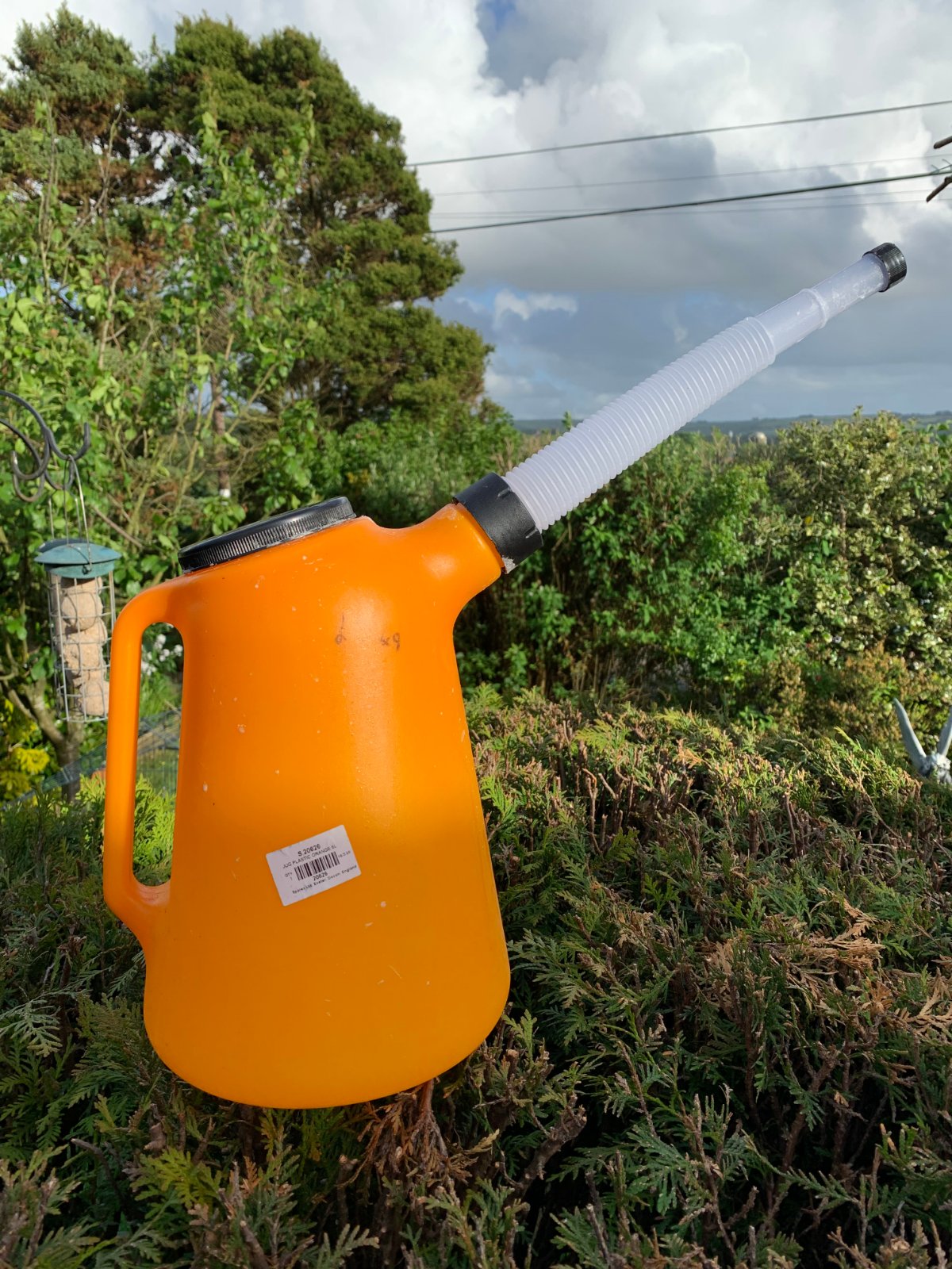

Well all done, nobody died and nothing got sprayed with corrosive liquid!
By a lucky coincidence the new 6" funnel plugged into the tank and held itself up. The pouring tube supplied with the bottle was sufficient to get a good enough aim into the funnel while tipping it, it was probably 6" above the top of the funnel in the earliest stage. Then, once it got going, the tapered neck inside the funnel happened to be just the right size for the tube to plug into. All a very nice coincidence, will keep this one funnel labelled in a clean bag reserved for this job. It definitely couldn't have been done without the funnel, evidenced by the white residue around the boot floor (now wiped off).
I overflowed it, I don't think there's really an alternative if using a big bottle without decanting. However, the access hole is (after removing the cap) basically a hole right through the bottom of the boot floor. The plastic filler tube is suspended in the air some way below it, with the ground below it. So even if overflowed it will not contact the bodywork. My theory is that a good overflowing will remove any floating contaminants! I just rinsed it off the driveway with water.
I also thoroughly cleaned the vent cap, to avoid the risk of it inhaling the muck around it. I did notice that it states "MIN 3.75L" on it (the number may or may not be exactly right, from memory). Is this the minimum that should remain in the tank, or the minimum amount you should add per fill?
