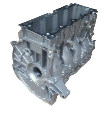

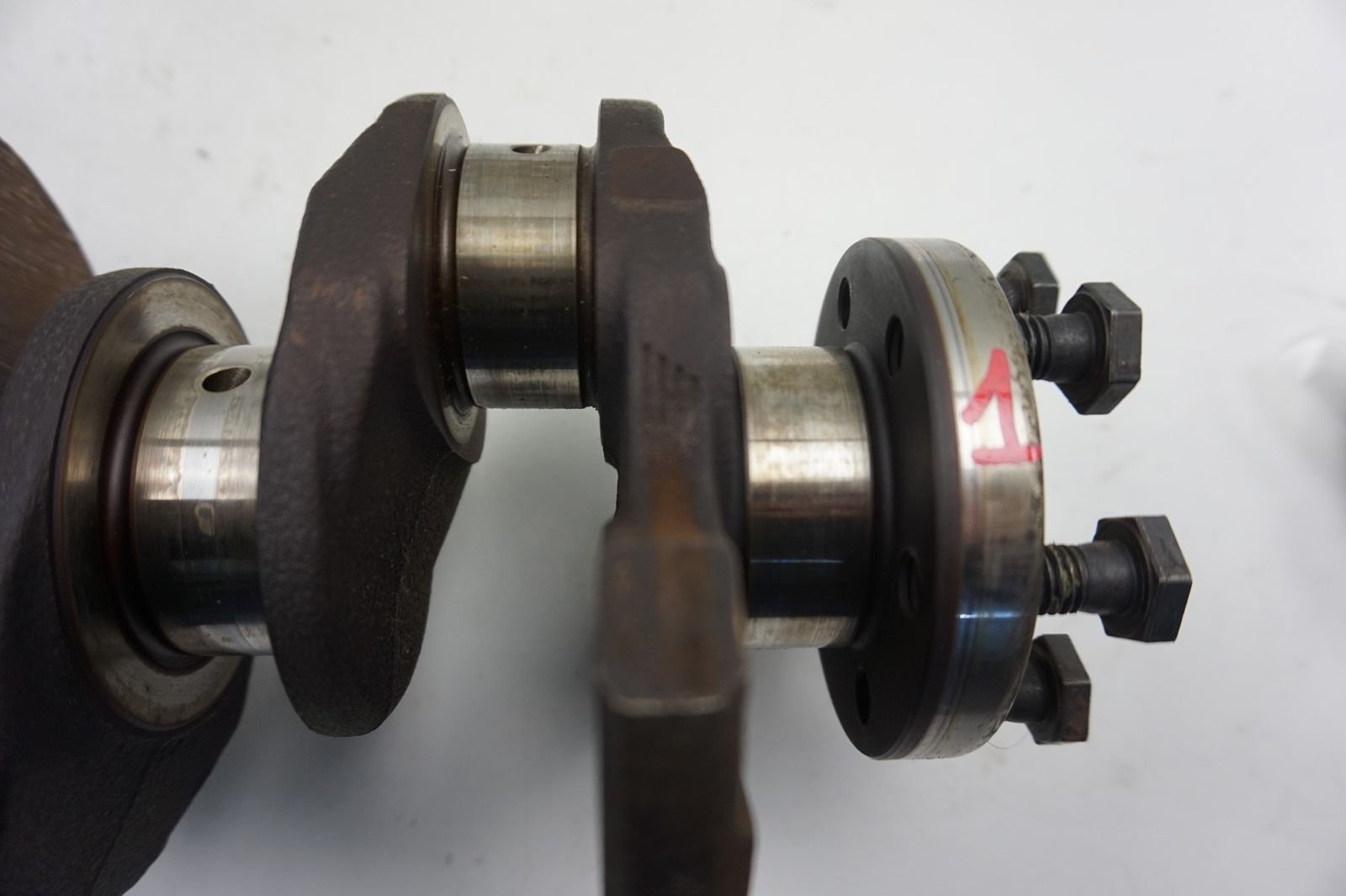

Yes, I am the same as you and there is no oil coming out of the flywheel bolt holes whilst they are removed. I have found a picture of a crankshaft removed and the bolt holes are definitely through holes as in the attached picture. It is a mystery why oil is not coming out of them as if you look at a picture of the block (attached) then it should be wet with oil in that region. Maybe there is not enough oil in that region to cause a problem but I don't trust this car as it would leak oil from the headlight if it could.

Is that a pic of a crank from the same engine as yours or just a random one? I’ve never looked that closely at the holes, i always just assumed they were probably blind holes.
What i can say is in over 20 years in the motor trade fixing cars i have never seen an oil leak from a flywheel bolt hole, i’ve never even seen a bit of oil dampness on any flywheel bolts that i have removed and the hundreds of flywheel bolts i have re used with a clean & bit of fresh loctite as far as im aware have never had any issues. I think you are over thinking it but if your worried about reusing them then maybe best replace them with new ones.

That is a picture of a crank from a KFV engine which is the same as mine. I was going to get some loctite 243 but nobody had any in stock locally and it was just £15 for a set of bolts o that is what I ended up doing instead. As you say, I am probably over thinking it but learning along the way. I am not sure what worries me the most - the car still leaking oil or the wife's moaning that her car is still not fixed.
