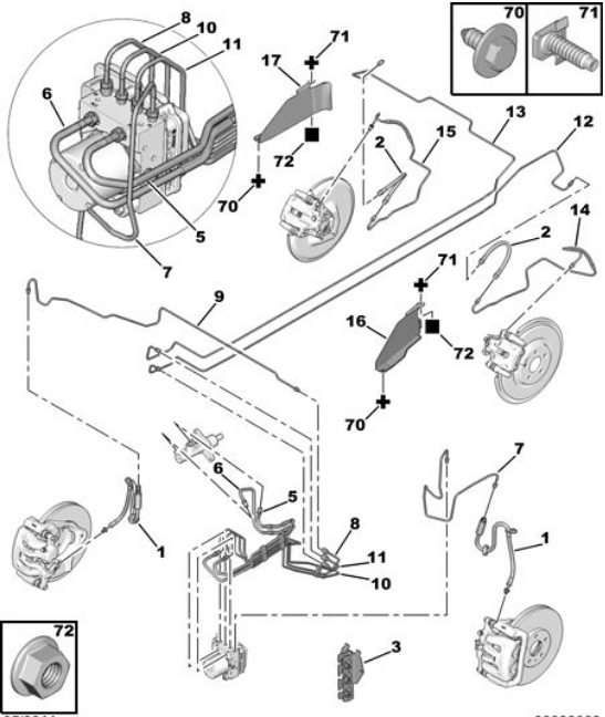

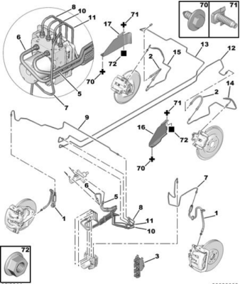

Thx for the info Marc, that was what I was expecting. My garage told me the brake pipe lines aren't available, is that correct??

Rp0thejester wrote: 04 Jun 2022, 19:03 Thx for the info Marc, that was what I was expecting. My garage told me the brake pipe lines aren't available, is that correct??
Again, it depends on which pipes you need - some are and some aren't:
Available: 1, 2, 7, 8, 9, 10, 11, 14, 15,
Unavailable: 5, 6, 12, 13

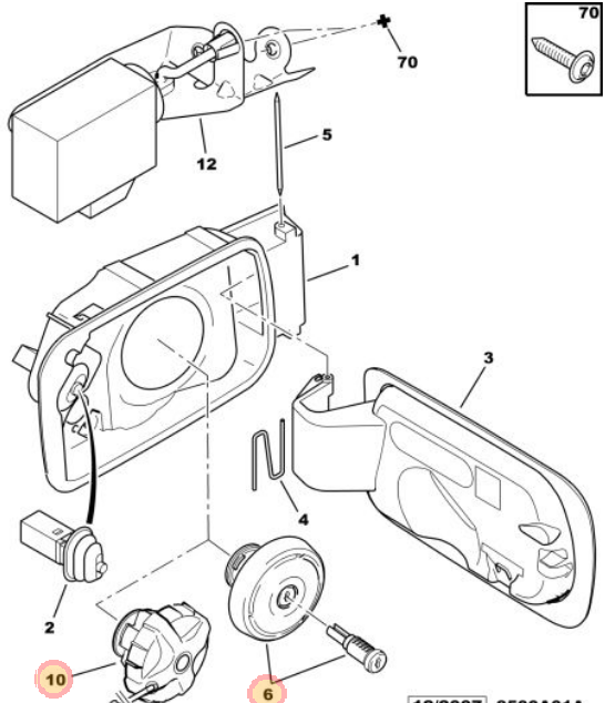

GiveMeABreak wrote: 04 Jun 2022, 17:23
jamescarruthers wrote: 04 Jun 2022, 16:43 Hello all. My sister has managed to loose the fuel filler cap for her 2001 2.2 C5… it’s the magnetic type that tells the car to inject Eolys fluid so I’d better get it replaced pronto!
Can I have the part number, please, and is it still available to buy from Citroen? If not I’ll get a second hand one.
James, if this is for your VIN ending 665, then there were 2 options - a locking cap and a non-locking cap:
(6) Locking
Combination specified on order, part: 1508J4, £72.88
Random Combination, part: 1508J3, £101.77
(10) Non-locking was part: 1508F7, £19.09, but no longer available.
