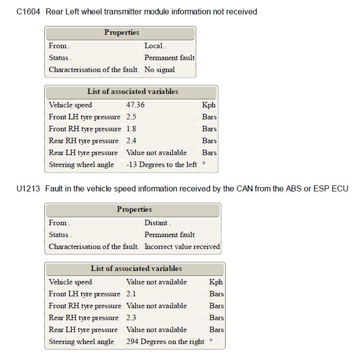

OK, Lexia test complete. I have two faults on the TPMS -
I also have this -

I also have this -

Those are the valve stem repair kits I mentioned and not the actual TPMS sensors themselves, which are fixed inside the wheel rim.
From the above, the system has been disabled which is causing the faults. It seems that the readings are inconsistent with the front right hand sensor appearing low (1.8) at one reading and then absent on the other reading. The rear left hand sensor is not being picked up, so I suspect the internal battery on that one may have failed (end of service life).
With the vehicle now over 18 years old, these have done pretty well if these are the original sensors and I suspect the previous owner couldn't be bothered to replace a failing sensor so had the system disabled.
If you re-enable it you will have warnings popping up all the time warning you about the faulty sensor (s) so you have to decide what you are going to do. Live without the system, or replace all the faulty sensors and valve kits and then have the system re-enabled - which will need all the sensors re-pairing to the ECU.

Thanks Mark. The issue which I currently have is with the valve stems on the front wheels, which have stripped threads, meaning that I can't screw my inflator on. The front right wheel has had a slow puncture, which may account for that message. The rear left has a traditional shaped valve stem on it, so I would imagine that was changed on the cheap, when that tyre was changed.
