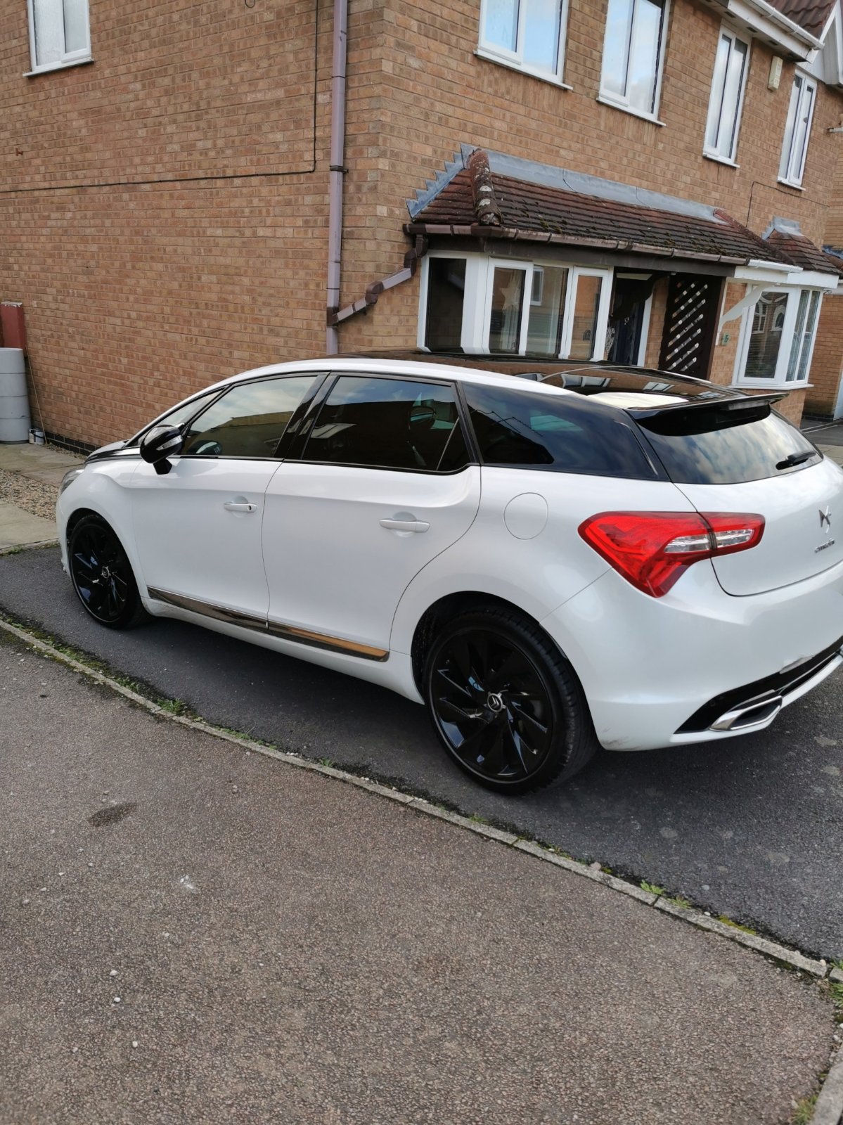

Hi all,
As the topic says I'm a first time DS5 owner and my car is a 63 plate DS5 2.0 HDI in the metallic white with the 19 inch alloys refurbed in full black
Anyone got any hints and tips for me regarding the car?
Few questions too
1) The car is a little slow to warm up, especially on colder days, is this a sign of the Thermostat needing replacing or just a diesel quirk?
2) Are there any particularly recommended head unit upgrades that people have done, I'm an Android user if that helps, before I upgrade the cars integral sat nav/stereo etc?
3) Is the integral sat nav actually worth
updating?
4) What's the cambelt replacement schedule?
5) I have what feels like a slight clunk when I turn left that you kind of feel through the pedals? Make any sense to anyone?
6) Best engine oil to use?
7) The cup holders seem to have been made for incredibly small cups?! Anyone come up with a good solution to this at all?
8) When I wash the car, it seems to lock and unlock randomly when water is sprayed over it - is this just a case of moving the keys out of range?
9) Night performance of the reversing camera is useless - not too much of a worry as I'm from an era where we had to learn how to reverse properly but wondered if there's an easy solution to this?
10) Any preferences on tyres for this one?
Any help, hints and advice much appreciated
Thanks
