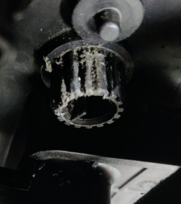

So, the good news is that the heater matrix isn't blocked. More good news, is that the temperature control motor works fine.
Bad news is that the gear wheel on the heater box which controls the flap is sha@@ed. Two or three missing teeth.

Re: C4 Split Cabin Heating
Dont panic, there is a modification repair kit available for just this fault. You fit a toothed sleeve over the damaged gear then fit a little bracket over it before you fit the motor back on. It comes as a kit to do the temperature flaps & the distribution motor too.
The dealer part number is 1607044080 and its £27.19 inc VAT but there are plenty on ebay around the £25 mark.
Oooohh, lovely, thank you. Just ordered one.
