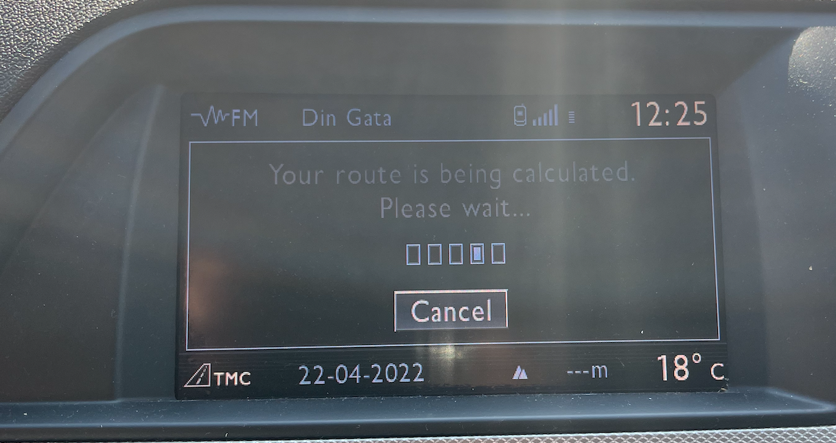

I find a way to update the system on Youtube and ended by buying a new map (SD card) from ebay.
When i bought the car and drove home the system coulnt calculate route, said area missing, I thought it was because of the olde map.
But now when I got the new map, i keeps saying the same.
So I have uploaded this photo of the display - can anyone identify if the GPS tracker in the car is broke?
I have ordered a new GPS with Fakra connection and the keys recommend in the forum to install it on the radio.
Best Regards

How many satellites do you have visible? If these are sufficient, then you may have bought a dodgy map - PSA don't sell maps on ebay - they will likely be pirated copies - send it back.

Think the map is functioning all right, i can find a lot of POI, hoped you could tell how meny satelites there was availeble from the photo I posted above....

Ok,so you need to make a long press on the SETUP button, then select GPS coverage. remember it can take 4 minutes after starting the vehicle for the GPS to lock onto the available satellites. So wait for at least this time before accessing the menu, then see how many satellites it is reporting. This can also affect the altitude reading, which in your picture is not displayed as a value.

Unfortunate, as i thought, it says 0 conected satelites and poor coverage.
When I see info, i says 2021 map and 2022. 04 radar ....
I have connected a new GPS from China, I also have one from germany I will try to connect, should it work or could it just be the headunit there is faulty?

You won't know until you have first tried an aftermarket GPS aerial, buy plugging that in and placing it somewhere suitable. But you must then actually drive around for 10 minutes or so for the GPS to locate and lock on to any satellites. Standing still won't be sufficient as the vehicle needs to be moving to calibrate.
If you have some satellites showing then you can put it down to the aerial. If not, then further investigation is needed.

I tried driving around with one of the GPS and didnt find any satelites. I will try with the other one today.
Seem wierd that the unit can locate but not find anything?
Could the unit GPS reader be damaged?

Without satellites to lock onto it can't geo-locate you so your position will not be correct. Yes the GPS unit inside may be faulty but is not separately user-replaceable AFAIK.
