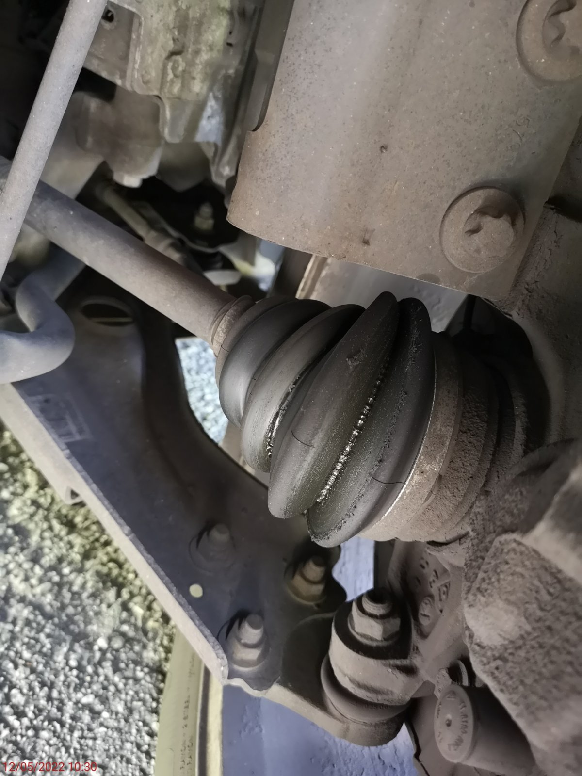

Is this CV boot knackered?
It has grease on the outside - I'm thinking it shouldn't? Would this be covered under a citroen extended warranty?

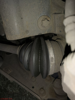

Re: Is this CV boot knackered?
If its showing signs of loosing grease then yes it's knackered and an mot failure.
I expect it would be classed as wear and tear unless your warranty states otherwise.
I see no visible splits and no sign of grease leaking (it flies out and covers everything in its path) That CV boot will pass an MOT and is serviceable.
