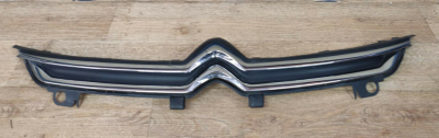

One more question. I noticed a little crack on the plastic between chrome parts that make a citroen logo above the front bumper. Are those two chrome parts and plastic beneath/between them separate from the whole bumper? Can I just buy that middle part beneath/between chrome and replace it?

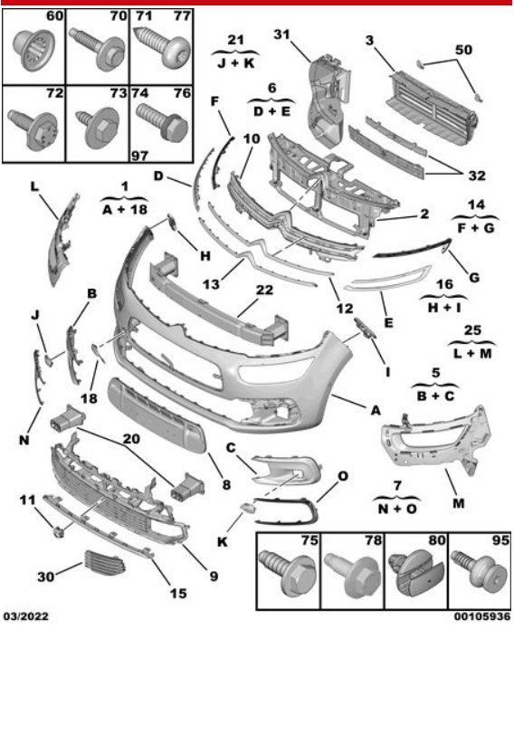

The 'Emblem Bracket item (10) is a complete unit that includes the logo as you can see. Part: 1617536680 £105.17 in the UK. The 2 chrome parts (top and bottom) that make up the logo can be removed once you have the backing plastic containing them removed so you can get to the rear, but as far as I can see, spare parts only have the whole emblem support and the chrome bits as one part.larjandukic wrote: 06 May 2022, 23:35One more question. I noticed a little crack on the plastic between chrome parts that make a citroen logo above the front bumper. Are those two chrome parts and plastic beneath/between them separate from the whole bumper? Can I just buy that middle part beneath/between chrome and replace it?
Unfortunately, as this is fixed in with multiple clips behind the bumper, it is necessary to remove the bumper to get to it. Be careful though as the headlamp washer pipes and other cables may be attached behind the bumper.

part 10! thanks for sharing this.
ok, i understand! the part you linked is not for my car, i have a restyled version. is it possible to order that from citroen dealer or is it too late for that now? and if you can give me right catalogue number for that and for the chrome parts also? thanks!GiveMeABreak wrote: 07 May 2022, 10:07The 'Emblem Bracket item (10) is a complete unit that includes the logo as you can see. Part: 1617536680 £105.17 in the UK. The 2 chrome parts (top and bottom) that make up the logo can be removed once you have the backing plastic containing them removed so you can get to the rear, but as far as I can see, spare parts only have the whole emblem support and the chrome bits as one part.larjandukic wrote: 06 May 2022, 23:35One more question. I noticed a little crack on the plastic between chrome parts that make a citroen logo above the front bumper. Are those two chrome parts and plastic beneath/between them separate from the whole bumper? Can I just buy that middle part beneath/between chrome and replace it?
https://www.ebay.it/itm/124614475906?ha ... SwY4NekgwD
- x 6955
Re: C4 Picasso "possible" upgrades?
I just found a link with the same part referenced in the item (if you look at the listing), but I'm not the seller so can't guarantee that - that's your job to do
- but it's just for visual reference and will be the same fixing regardless.

... and by fixing, I mean how it is attached at the back.
