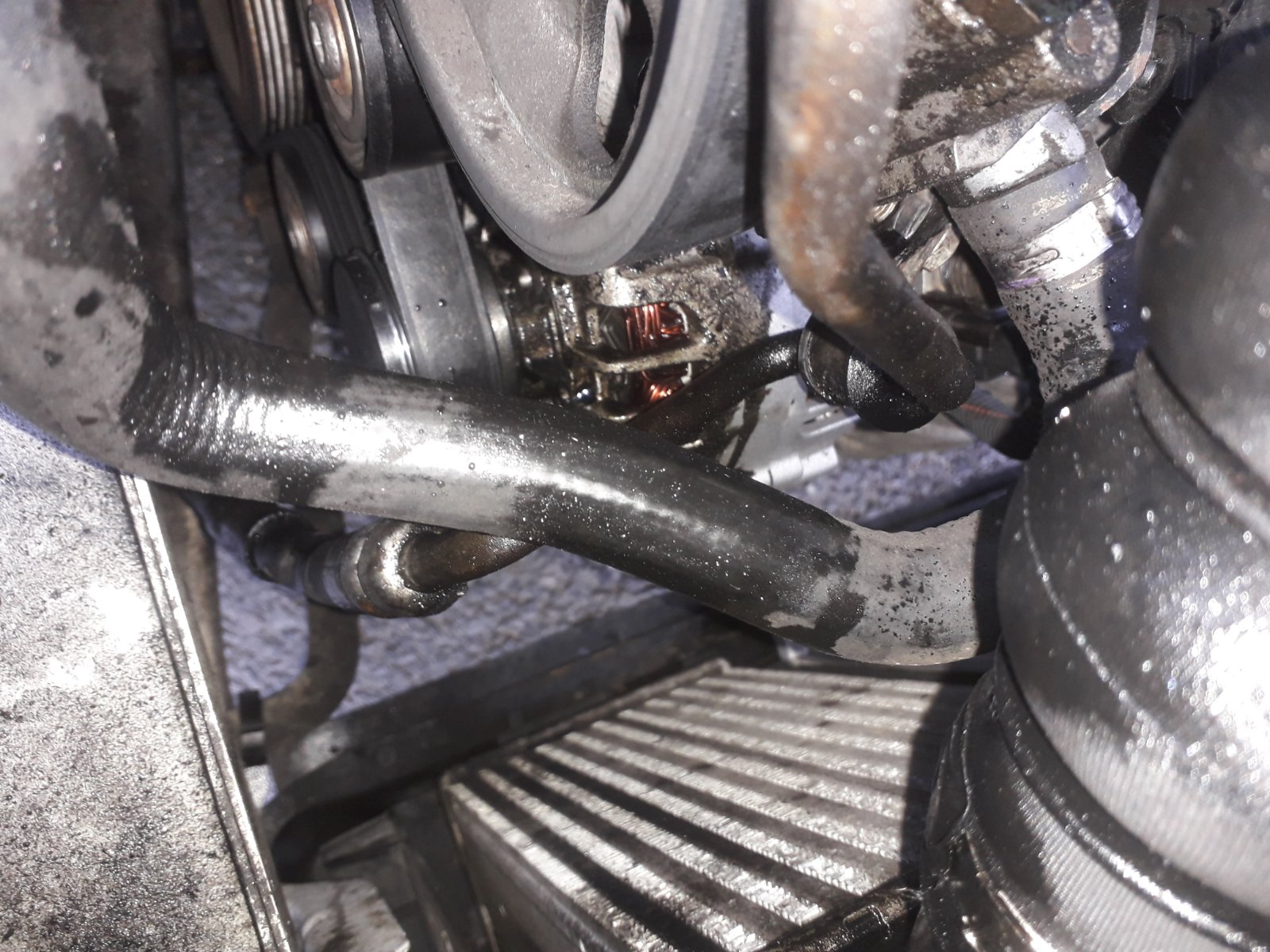

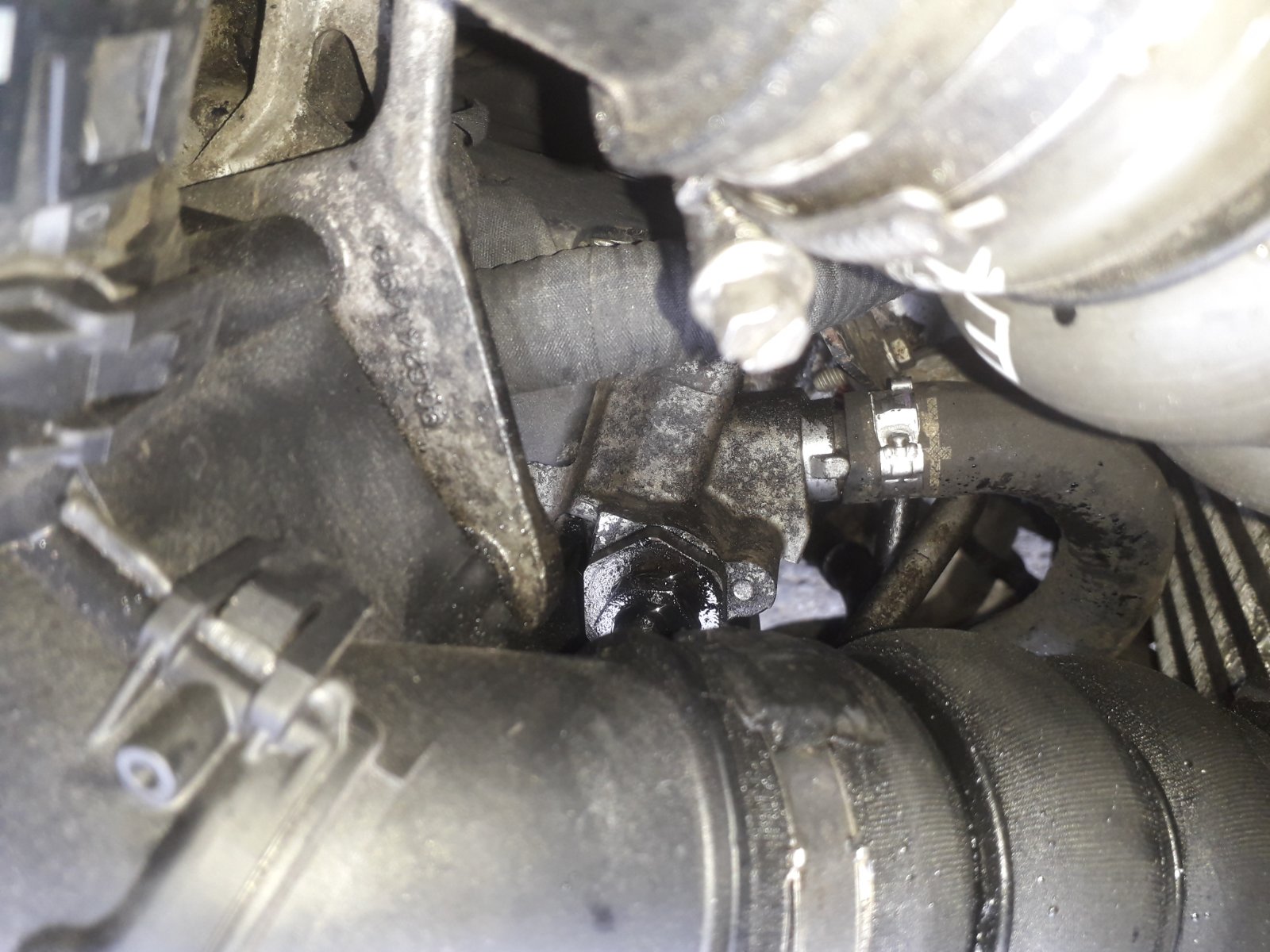

Re: Recon engine.
Well after replying it started and abit off a whining noise with a big plume off smoke out from the exhaust now will only turn over but not start,checked to see any oil,oil coming out off some fitting & as shown on pic it's going on the alternator.
- Posts: 11773
- Joined: 02 Apr 2005, 16:11
- x 1240
Re: Recon engine.
Probably coming from the engine breather which would indicate possible failed piston ring/s. Take the oil filler cap off, if its blow by you will get lots of smoke from it. if you can get it to start that is. Not turning over very fast is it? that would indicate a broken cam belt.
