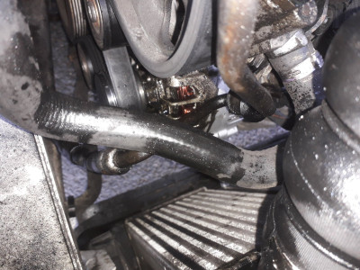

Well after replying it started and abit off a whining noise with a big plume off smoke out from the exhaust now will only turn over but not start,checked to see any oil,oil coming out off some fitting & as shown on pic it's going on the alternator.

Re: Recon engine.
Probably coming from the engine breather which would indicate possible failed piston ring/s. Take the oil filler cap off, if its blow by you will get lots of smoke from it. if you can get it to start that is. Not turning over very fast is it? that would indicate a broken cam belt.

Re: Recon engine.
Morning Peter
Do has you said took the oil fill cap off & yes smoke was coming up from there,wouldn't say lots of smoke but definitely smoke.
