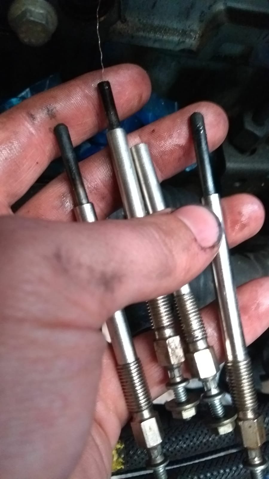

I'm not rushing into Glow plug replacement, this is why I ended up taking the engine out and head off my wife's 206 HDi:
Glow plug (partial) removal
Don't fancy that job on the C5 at the moment!
Matt
