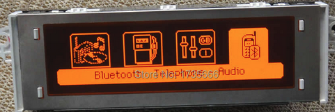

The display menu looks like this, except the 4th menu option is missing (picture from google, but it's the same):
"Type C" display software version
- x 6960
