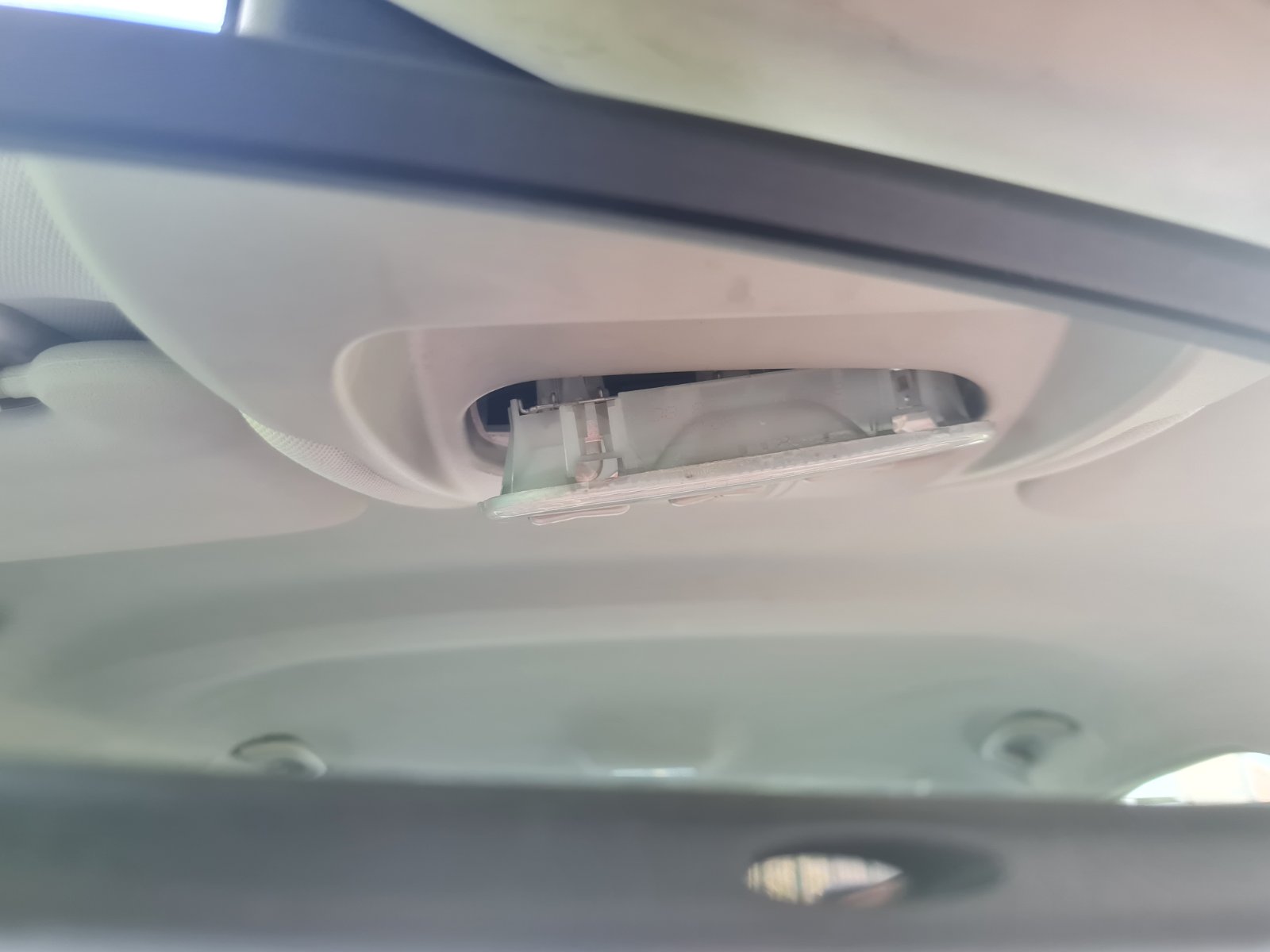

Re: Replacing the interior door storage light on C5
Post by H4wkeye »
Cheers Marc. I shall attempt that. Could've made it simpler tbh :-D I also realized later that apparently I could've just popped the plastic with a spudger or something without removing the whole thing first... Too late for that now.

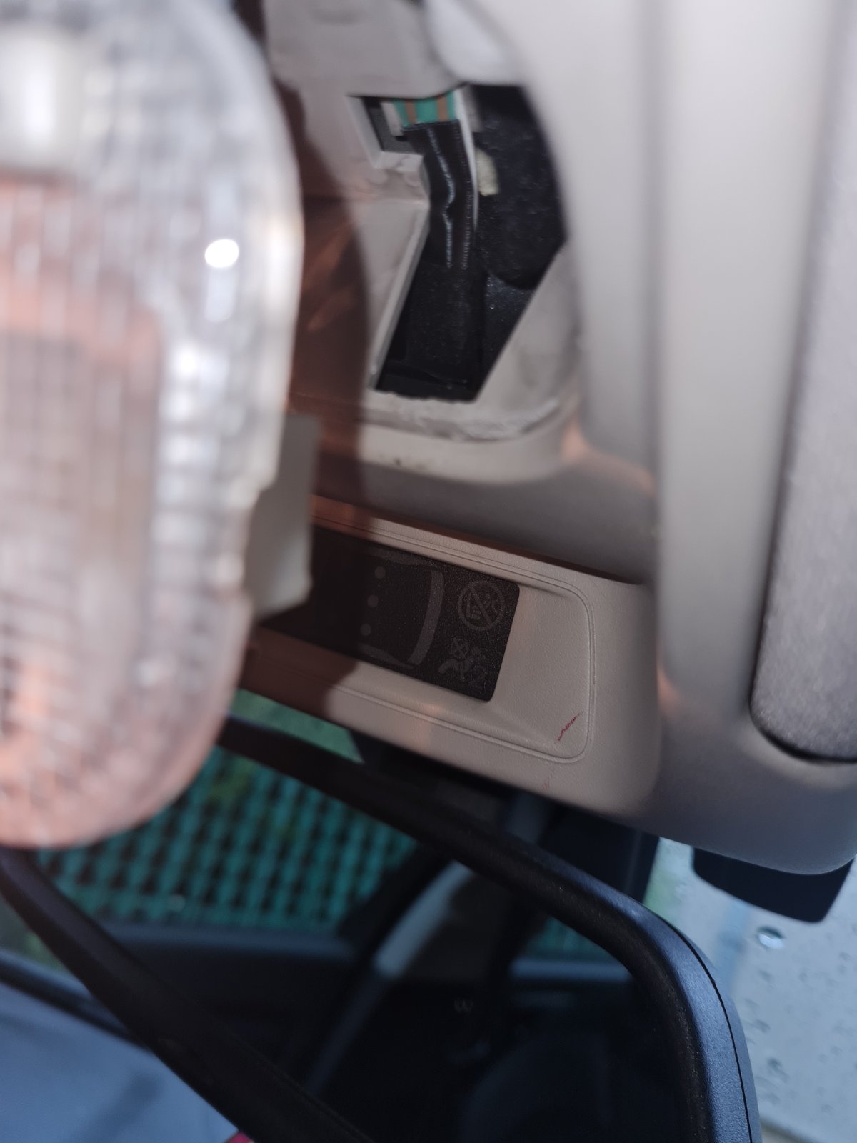

I cannot figure out where the metal clips are suppose to pop in. Is this the metal piece I'm suppose to hook to something?
Edit: Seems the other metal clip is missing I can only see one. Maybe old owner broke it? Can I use some plastic glue to attach it? I can see on the edges of the assembly some residue, maybe from previous glue.
H4wkeye
(Donor 2022)
Posts: 145
Joined: 06 Apr 2022, 00:15
Location: Europe
My Cars: 2011 Citroen C5 X7 Exclusive 2.0 HDI
x 14
Post by H4wkeye »
Yep. One clip is definitely missing.
Post by GiveMeABreak »
Yes looks like this has broken. Is this the front assembly? The pictures I provided before were for the rear, but they are similar units. The metal spring clips are just to provide the tension once the unit is put back in place to stop it falling out. The clips don't go into a recess, but just press against the inside of the head lining recess (at the rear) or against the trim of the roof console at the front.
