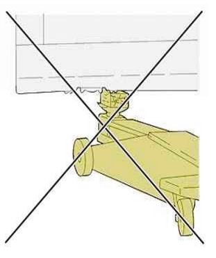

Hi guys, i know where the jack points are for my C4 GP, but where are the Axle Stand points please?

Re: C4 Grand ~Picasso (2014) Axle Stand point?
| Don't position the stands under the jacking points. | Don't position the Jack away from the lifting points | Positioning of the Stand |
Hi Marc,
I'm a little confused, so does this stand go next to where the jack point is? if so how do i put it there if the jack is there already (to lift the car up) ?
I think they mean the actual 'points' as in the pointed parts of the jacking area, where I have marked with red dots.
Some vehicles may have a 'lip' like metal part where the jack goes under and these can have some pointed ends. In other words don't put the stands under any pointed parts of this plate, make sure it goes evenly over the jacking point / plate, otherwise the stand will be taking the weight on a part of the jacking point and the weight won't be distributed properly / or it will damage the metal jacking part.
I can't be more specific as I don't have a Picasso, but the jacking points as per you owner manual should be followed.
