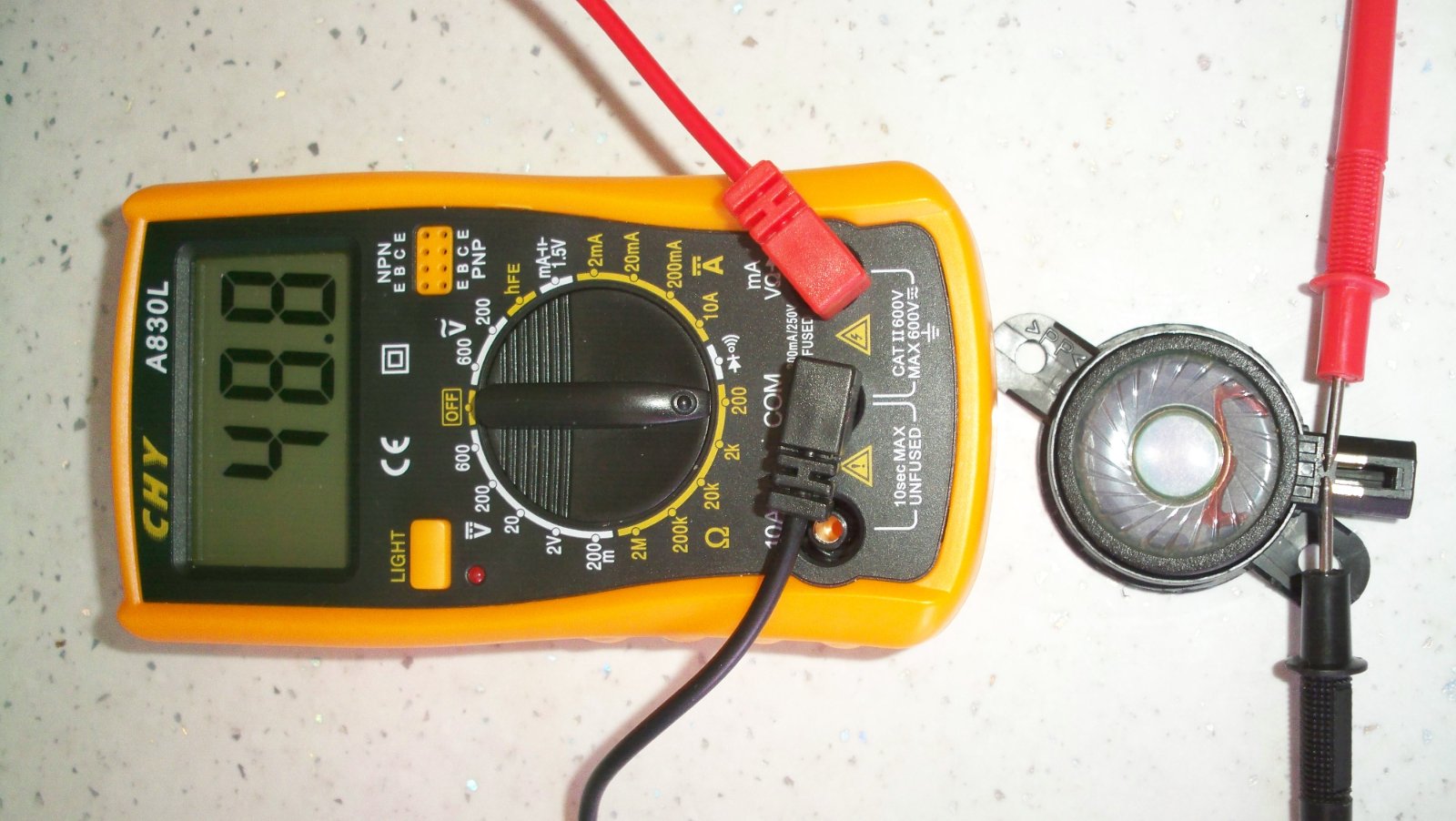

I noticed I was getting no sound from the rear parking sensors, nor was I getting any warning they were not working. Reverse lights and dipping mirror still worked so gearbox switch was OK. Lexia3 did in fact record a permanent fault "rear parking speaker open circuit or earthed" - quite specific! I was impressed that the car clearly measures the speaker circuit impedance but cannot determine whether it is open circuit (broken wire etc) or closed circuit (earthed).
Of course with no speaker, how would you find it? Luckily, last month I recovered the Cpillar trims and discovered the speaker screwed to the rear of the left trim. Who knew? I suppose the panel gives the speaker a bit more volume.
Sure enough, it was open circuit, but no visible damage. The black plastic housing contains a standard 36mm mylar passive speaker rated at 0.2W 50ohm - the kind used for headphones and telephone handset earpieces. However, its terminals are soldered and moulded into the housing. I found the genuine Citroen part 6590A6 for sale in Slovakia and Russia at £45 to £50 !! Used items on Ebay for £10+. Generic ones are available from China for under £5, but the connector may not match. However, I found on Ebay a pair of similar speaker inserts (50ohm, 0.5W) advertised as a pair for head phones - £3.99 the pair delivered. The speaker slots nicely into the housing (with top prized off) except for the terminals. By pure coincidence, the speakers terminals were sized and spaced almost identical to the connector pins of the original, so I pulled out the original pins, fettled the moulding and lined up the speakers terminals to align with the car's connector, and it worked perfectly. I did NOT refix it to the Cpillar trim, but under the rear left seatbelt spool trim for easier access.
