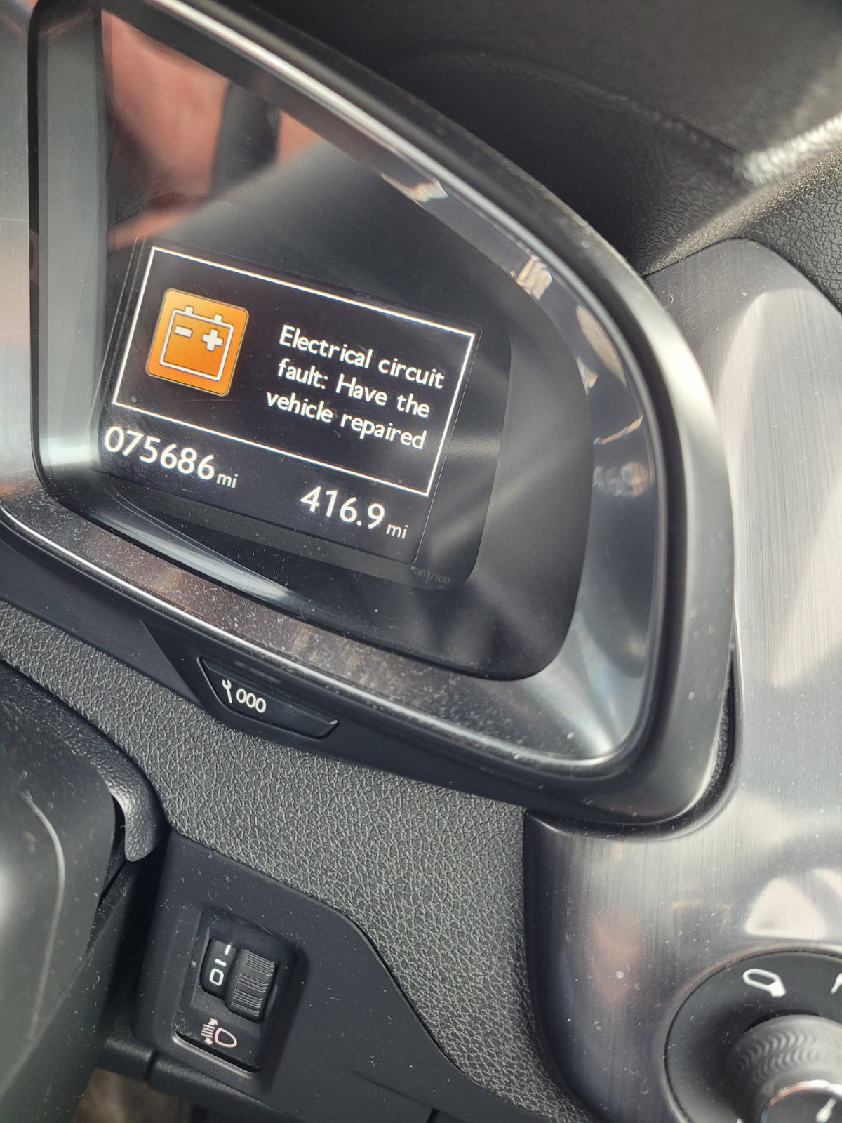

I have a 2016 DS5 that has recently started showing the Circuit Fault error message with a graphic of the battery. Went to local garage who said battery had 5% health left, so replaced the battery with new 096 AGM.
Fault still appearing at ignition, but car starts and runs fine, including stop/start, apart from the service light staying on. Plugging into OBD2 reader shows no faults.

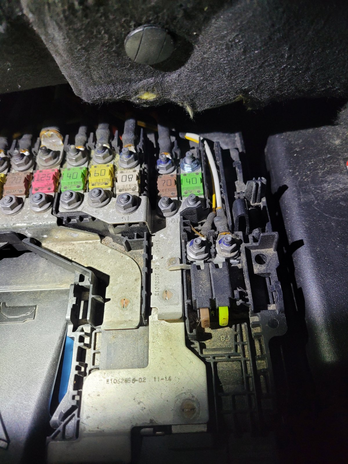

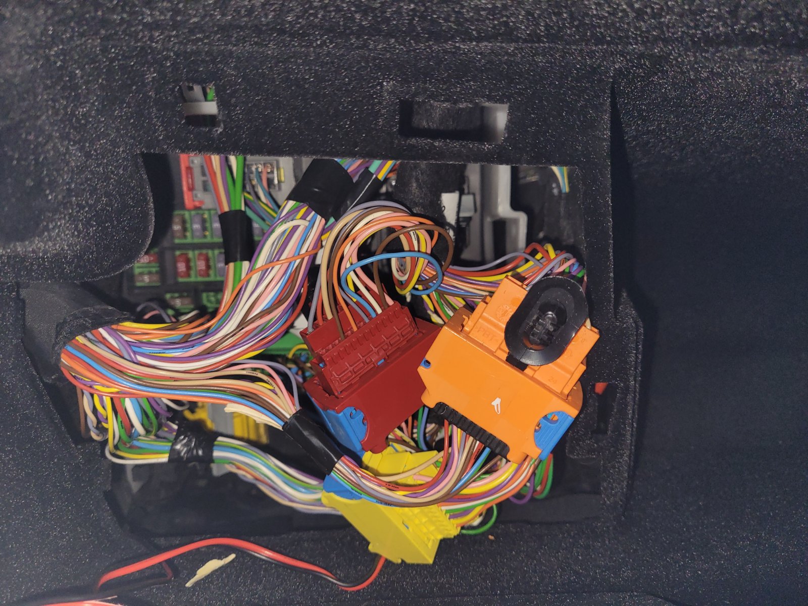

I think previous owner may have had issues, as glove box fuse area is a mess, and the insulation by the battery in the engine compartment looks a bit "abused".
So, does anyone have any thoughts on this? I am thinking possibly the battery management panel on top of the battery. I have removed, cleaned and replaced all fuses on this along with the connectors going to it. It looks like a relay on the front of it that does not click, so perhaps that? I have a "platinum" extended warranty, but no one seems interested to take it on.

Sometimes the electrical circuit specifically the Battery Charge Status Unit, can take a few hours to register the new battery and its health status.
If you can leave the car locked and uninterrupted (i.e. don't unlock it again) for 2-3 hours as it generally needs this amount of time for the Stop Start systems to calibrate when a new battery is replaced / to register the new battery and start operation again (assuming all the other factors are pre-requisites are present).
If there is a fault your generic OBD II reader won't cut the mustard with these cars. it need a proper diagnostic tool like Diagbox to be able to read the manufacturer-specific faults that general OBD II code readers can't do.

What is the red/black wire for in the fuse box (2nd pic)?
Doesn't look original.
DropThePuck
- Posts: 5
- Joined: 11 Nov 2021, 13:47
Re: DS5 Circuit Fault
That shouldn't be there. I had hardwired my dashcam into the fusebox with a saddle connector. I had just disconnected it to see if that was causing the problem.wheeler wrote: 11 Nov 2021, 19:30 What is the red/black wire for in the fuse box (2nd pic)?
