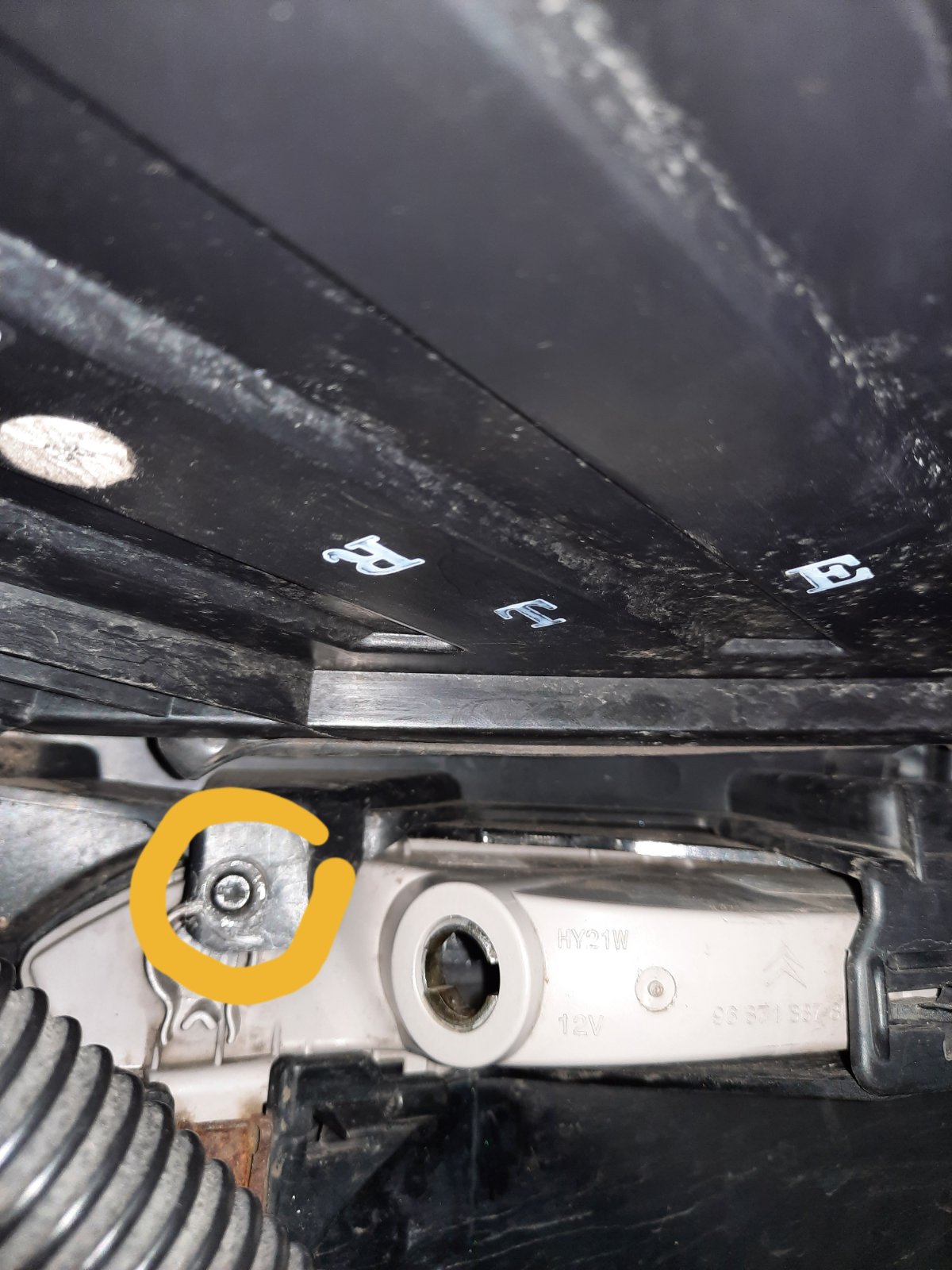

Re: DS5 front nearside indicator and dipped headlights
Hi, tried again to remove the indicator and think I've found another fixing but unsure as to what the head is? Looks like a torx with a slot. I managed to get a picture (that I hope is attached) Any help much appreciated
That IS a combination Torx/Slot screwhead. You could use either a Torx screwdriver (probably a T10) or a blade screwdriver to undo it. HP/Compaq use them in a lot of their PCs.
Hi many thanks for your reply. I tried a torx and slot but not a T10. Hopefully I can get it loose but its very tricky access.
Hi, just an update. Got 2nd fixing out and then indicator came out no problem without and bodywork removed. It was separating along its length so easy for water to get in. Cleaned it thoroughly let it dry for a few days then sealed the joint with clear silicone. Back in car for nearly 3 months and all good so far. Also after reading post about headlamp bulbs not seated right it checked these and what a difference. Car just passed mot so lights must be OK.
