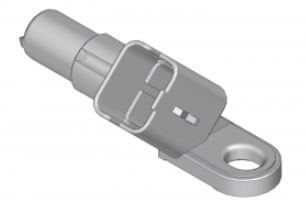

If it's the 1.4 HDi 70 then there is a camshaft position sensor:
... and a crankshaft position sensor (engine speed), which is the one you are probably referring to:

But what the location of both please 9
wheeler
Posts: 7927
Joined: 21 Sep 2002, 19:07
x 1056
Re: Location of crankshaft position sensor
Unread post by wheeler »
The cam sensor is located at the top of the engine pointing at the cam pulley, the crank sensor location is shown in the picture already posted.
