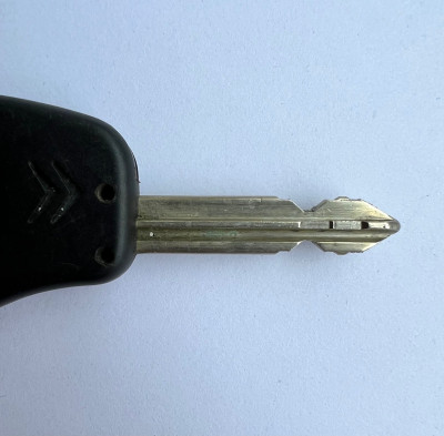

I left out that detail, so here it is. When he cut the first attempt, I pointed out he had not cut the side slots I think you mean. He said he "understood" those were for clamping the key precisely for key cutting, and left them uncut. However, after the second attempt failure, I asked him to cut those side slots as well, which he did. It was only THEN that the key got stuck in the lock.
Now, having looked at the 2nd hand key I have, those slots are different to mine....so they must be specific to the lock. The annoying thing is that I chose the more mature technician....I had previously talked to two other younger operatives, one of whom looked at my key with bemusement! I thought the 30-something bloke would be more experienced. Doh!

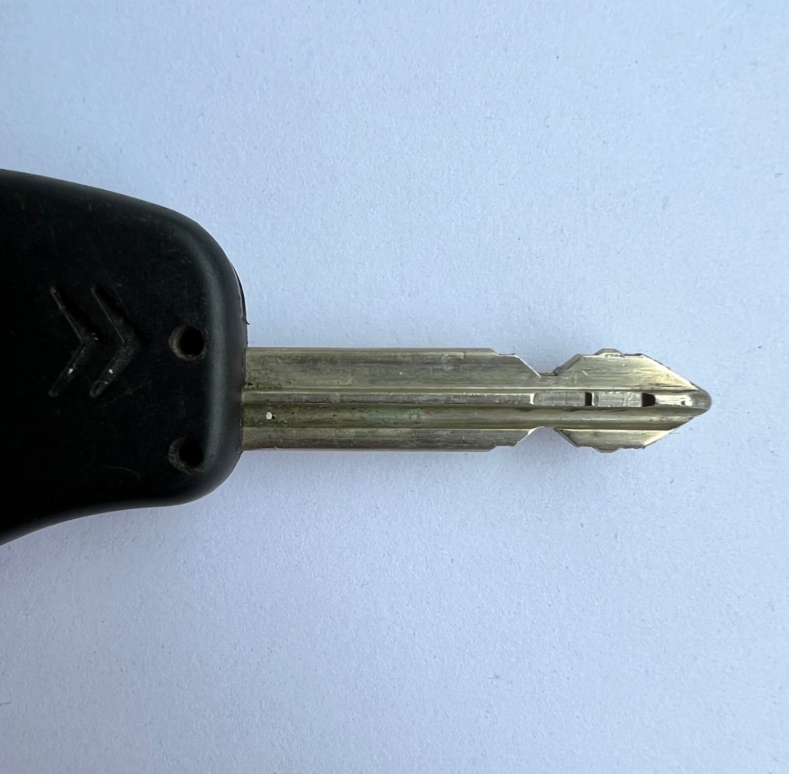

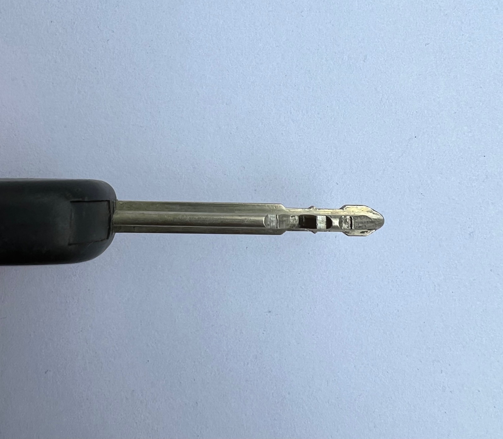

They certainly are, the cuts on the side are very similar to the main cuts, they have to be duplicated in the exact same way.aspire_helen wrote: 29 Apr 2022, 18:23
To be specific there are 62 different variations of the 'side' cut patterns.
The fact the lock was turning all the way around suggests the key is cut incorrectly, this is a security feature so that if the lock is operated/forced with anything but the correct key it just rotated & wont do anything. The strange thing is even if the code was cut wrong i wouldnt expect it to get stuck in the lock?
If you want I can try to decode the key for you from pictures & get Timpsons to cut it from code? Let me know & i can give you example pictures of what i would need.

I would need 2 clear pictures like this on a white background. Make sure to give the key blade a good clean. Would be interesting to see the key they cut also to see the difference.
Im surprised they dont have cut to code machines. Maybe this varies from branch to branch? A few years back i was speaking to one of the guys at a branch in Glasgow, he was showing me all the programming kit they had at the time, it was good stuff & the guy seemed very knowledgeable. Not sure if they did cut to code right enough as at the time i was only really interested in the programming side of things.
