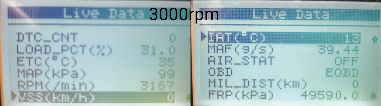

I managed to get some of the live data while running. Not sure how much help it'll be.
