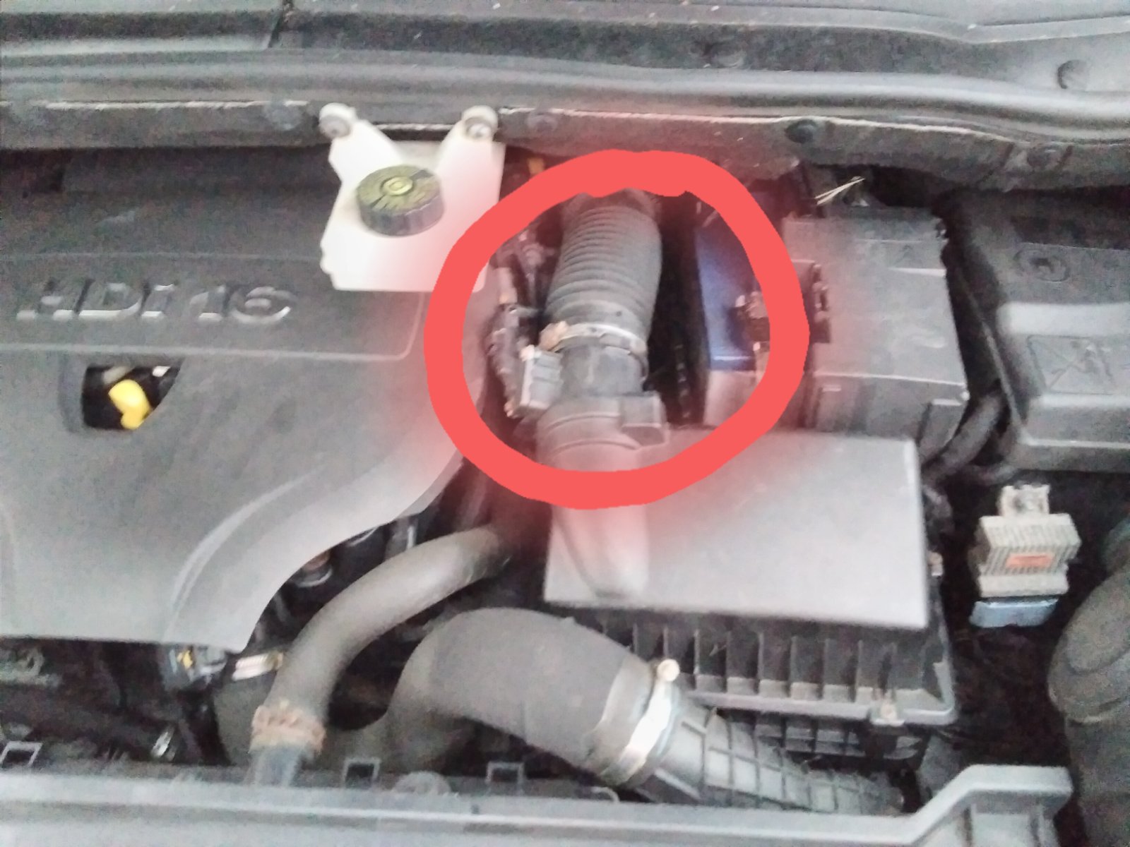

Ok, so I've recently bought some Holts EGR & Carb Cleaner Spray, so this is my engine, 2011, C4 Grand Picasso 2.O VTR+ HDi, full manual gearbox, Where do i undo the jubilee clip and spray towards the back of the engine, with someone keeping steady revs on as indicated inside the box? Image
