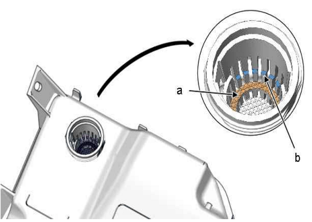

As for the LDS fluid, be careful not to overfill the reservoir. The fluid must be checked with the vehicle on the LOWEST suspension setting and must only be filled to between the 'a' & 'b' mark as shown.
