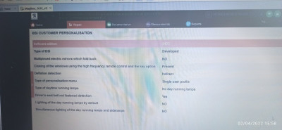

Ok, so in that case, pop your VIN up (automasked on post submission) so I can check what you are supposed to have equipment wise and I'll see if I have anything on this.

VIN VF3**************[VIN obfuscated, can be read by forum staff]
Thanks!

Ok, so your configuration shows that there is no hands free unit and no independent telematics unit fitted, which would explain that if the BSI has been configured to look for one, then it will throw a wobbly when it can't communicate with it.
As for corrective action I will be sending you a PM shortly.

Can you tell me what equipment it DOES have?
Thanks.

Great, leave it with me and I'll contact you when I've gone through everything.
