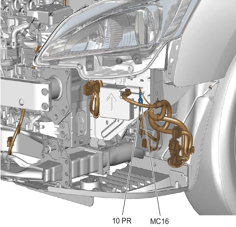

The Front Sidelights are managed by the Engine Fuse Box; the Number Plate Lights are handled by the BSI. I can't see any direct fuses for these 2 though, but of course the BSI is powered from the electrical supplies management.
Have a look at the earth point for the front DRL (sidelights): MC 16 is the earth for these.
Fuse F9 in the engine fuse box controls one of the internal Fusebox ECUs that the side light wiring goes to, so take a look at that.
