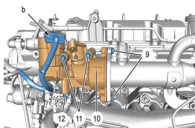

As for the torque:
The bolts (9) Tighten to 1 ± 0,1 daN.m
The bolts (11) Tighten to 1 ± 0,1 daN.m
Tighten the bolt (12) to 1 ± 0,1 daN.m.
