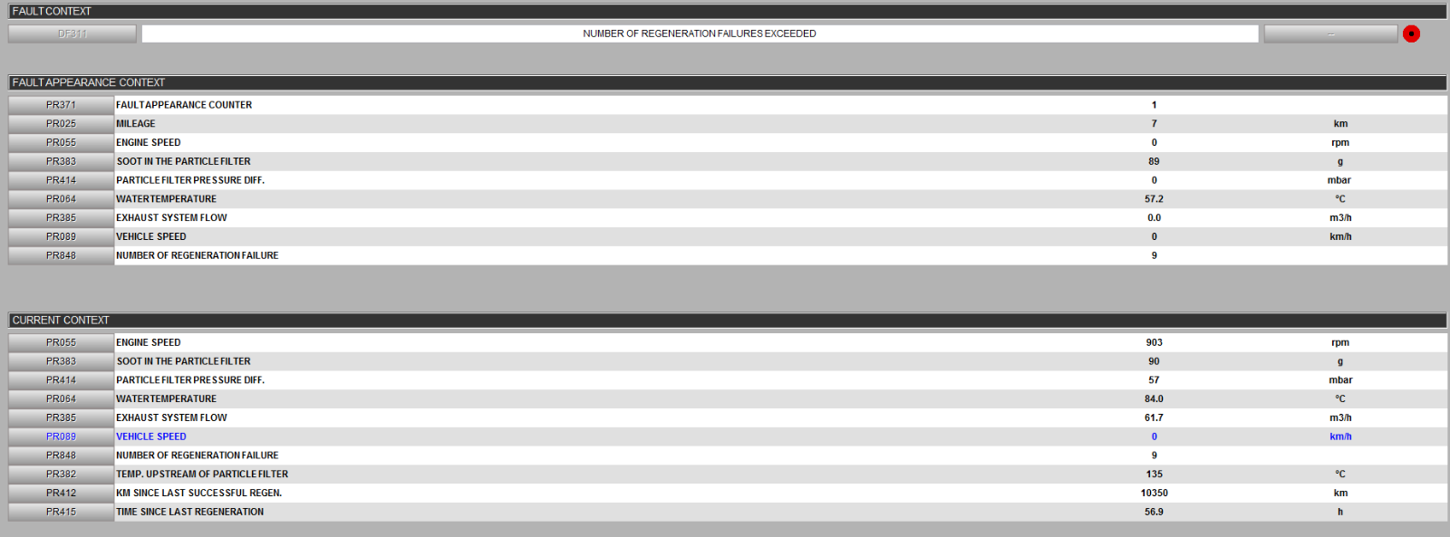

I have a 2010 Renault Espace that had to many failed re-gen attempts. We live on an island to motorway driving is impossible.
The DPF has been cleaned and I have Renault clip but I have no idea how to tell the car it's had a new DPF
Any help would be great
