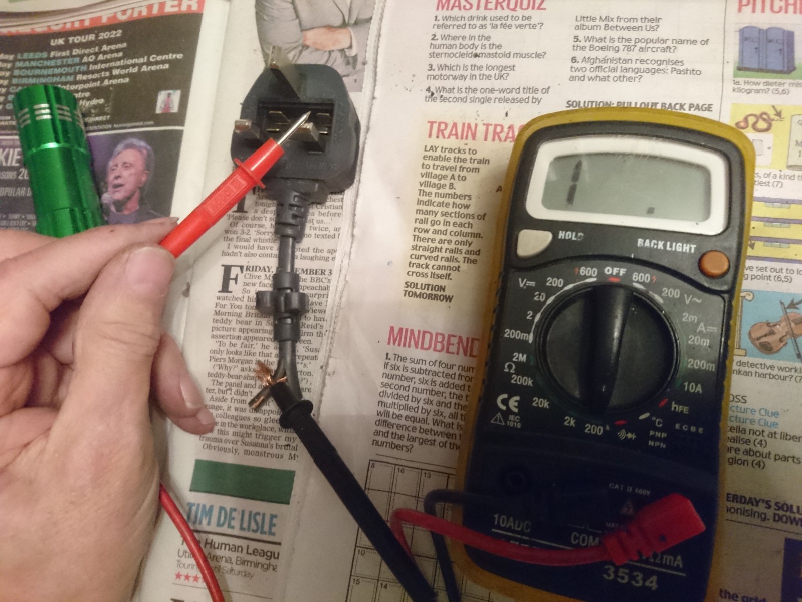

SWMBO was hoovering the carpet this morning when the hoover just stopped!! She did her usual checks of filters, plug etc, and left it to cool down to try again. An hour later it still didn't want to play so she brought it to me saying "I've done it again!!" She does not have a good record with appliances having destroyed 3 previous vacuum cleaners, 2 PC's, 2 mobiles and a washing machine to date!!
So this afternoon I looked into it for her and started by checking the fuse, OK, and then, as it has a moulded plug, I dismantled the casing to get to the switch and motor. I didn't think to take any pictures but I'm sure the inside of a vacuum cleaner is pretty familiar to most
Once I had access to the internals I started with a motor brush and impedance check, OK, smoothing capacitor check, OK and switch check across its terminals, OK. Hmmm! So I did a continuity test from plug pin to switch for the live, OK and from plug pin to the capacitor for the neutral, not OK!!! So I had a break in the neutral wire inside the lead. I cut the moulded plug off and stripped the neutral wires from the plug:
So as you can see the connection from the neutral pin to the wire has failed inside the moulded plug!! I fitted a new plug from stock and she is finishing the carpet as I type
So the moral of this story is if you have a moulded plug, as most things do these days, don't take it for granted!!!

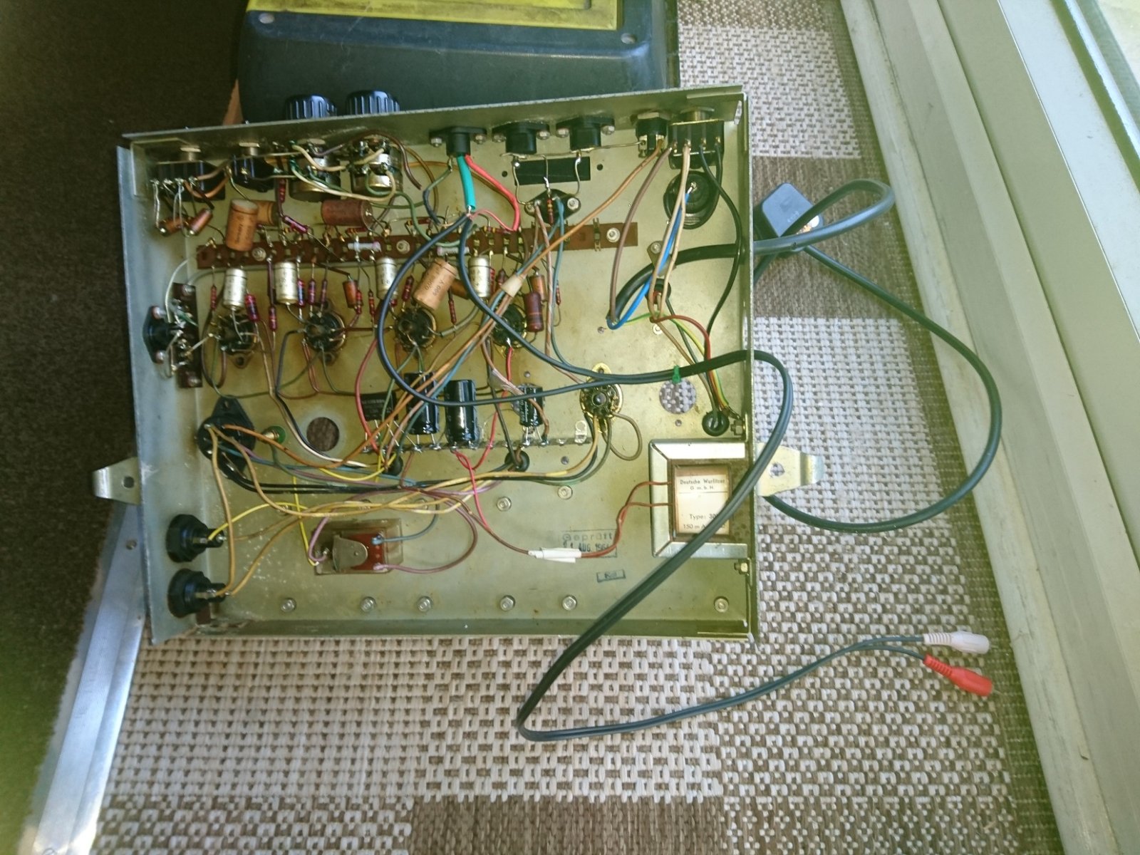

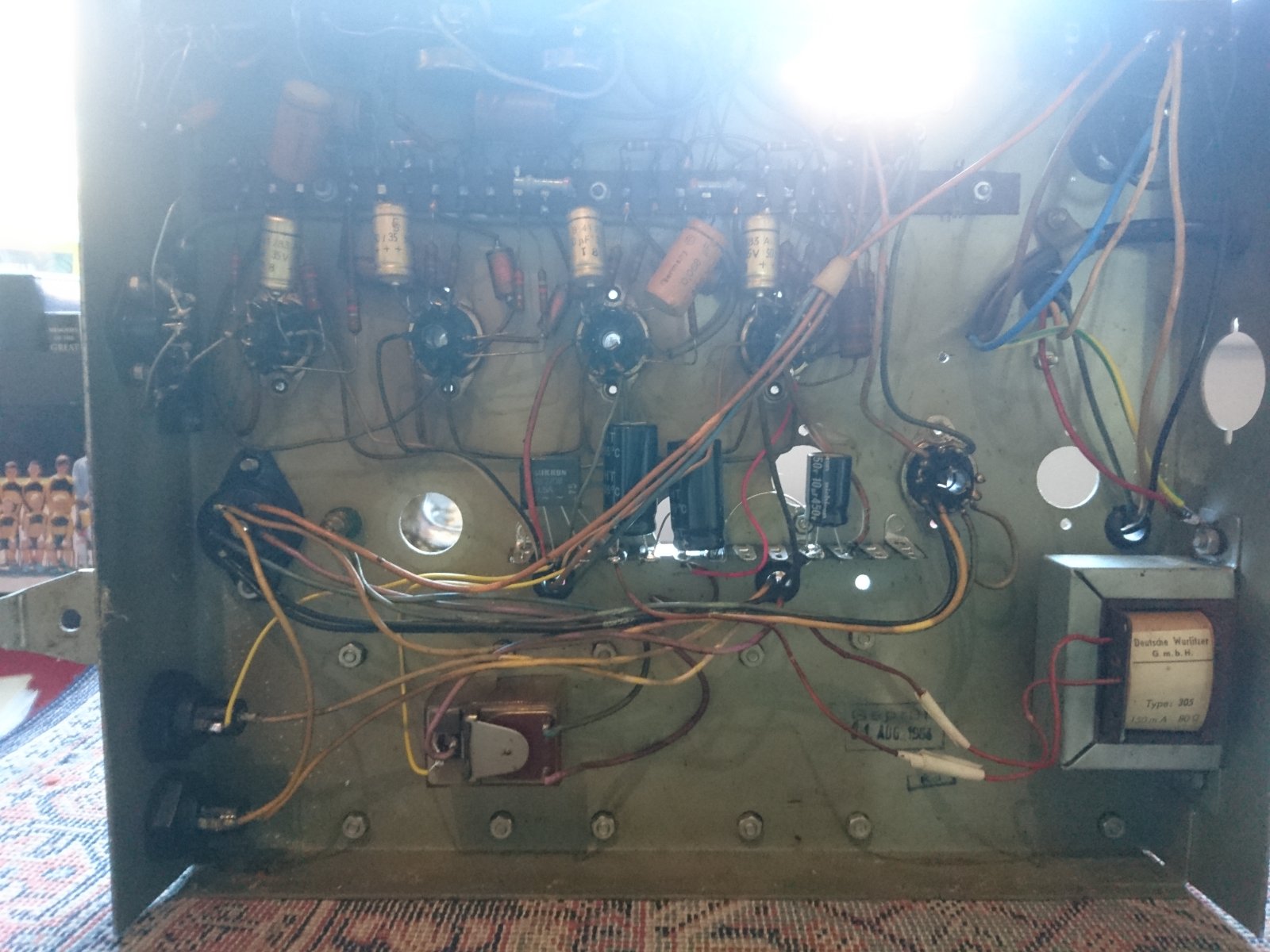

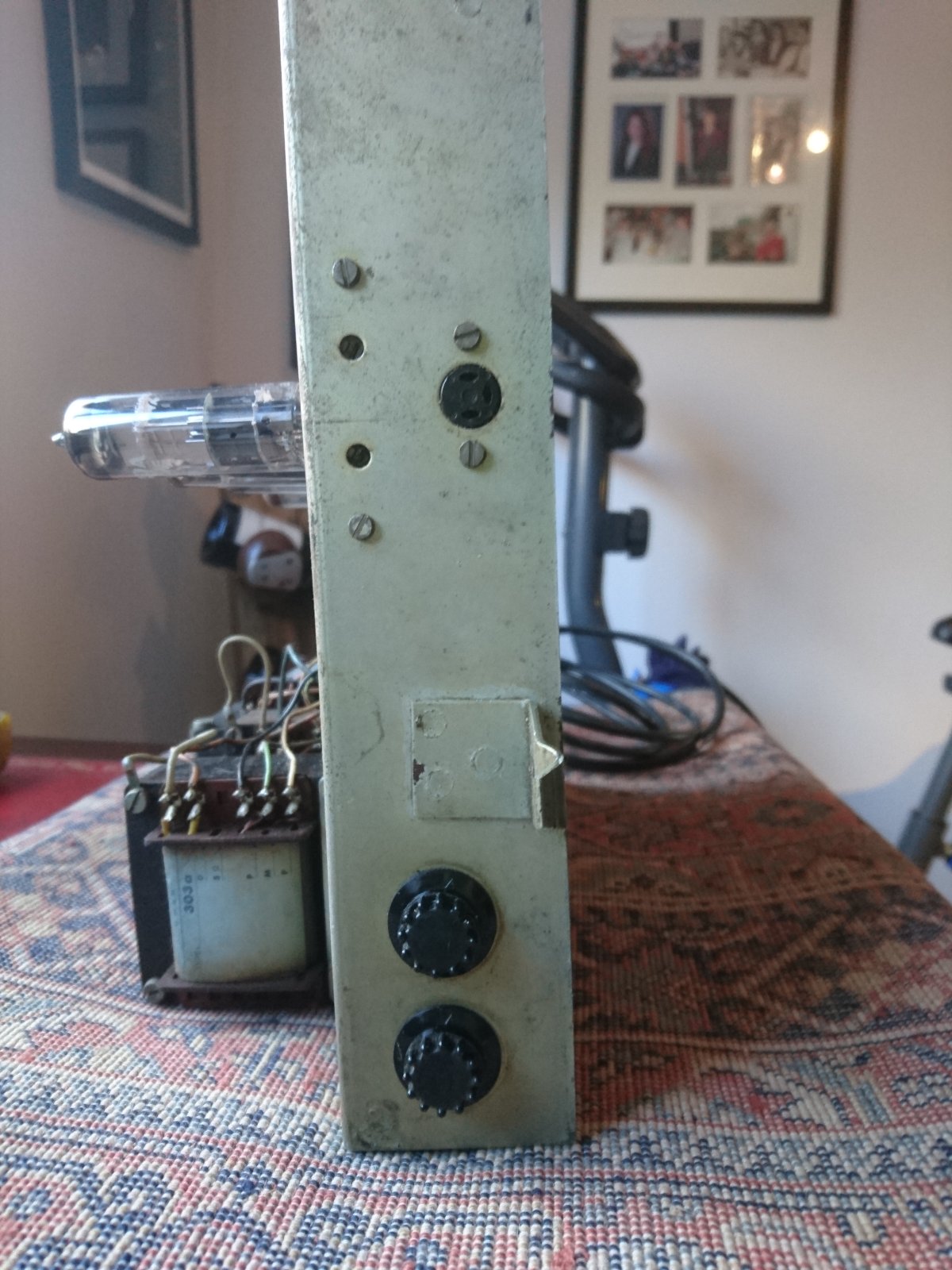

Today brought a visit to my friend's in Dunstable to see if I could discover the problem with his Wurlitzer Lyric jukebox. Apparently he switched it on the other day, all the lights came on as usual and the selection process began as expected and loaded the single he had chosen. He then watched the stylus move onto the disk and heard.....nothing!! Putting his head close he could just hear the direct sound from the stylus thereby confirming that the problem was in the amplification and/or speaker system. At that point he called me for advice so I popped over this morning for a preliminary assessment! Here is what I found:
I decided the best thing to do was bring it home and have a good look. As I gently worked through the wiring this happened:
So with reference to the diagram in the manual I was able to work out where it came from and refit it.
This picture has the red arrow indicating which wire it was. You can see that without it there is no power feed through to the audio circuits so I am hoping it is the problem.
However the power transformer has signs of significant burning and I discovered that the twin speakers (8 ohm) in the jukebox had been wired in parallel and connected to just the right channel, presumably because at some point in the past the left channel had failed and so the bodge was made by someone with little understanding. That would have meant loading a single channel with a 4 ohm load and hence doubling the current draw from the designed level which may have resulted in the burning of the transformer!!
So in view of that and the potential unreliability of the circuitry remaining, we have decided to replace the amplifier altogether so a bit of rewiring will be necessary to still feed the lights and selector mechanism as they currently operate as slaves from the amplifier power supply. I expect we will fit a modern preamp to the turntable output and then feed that into a modern stereo amplifier to drive the speakers. Fingers crossed!!
