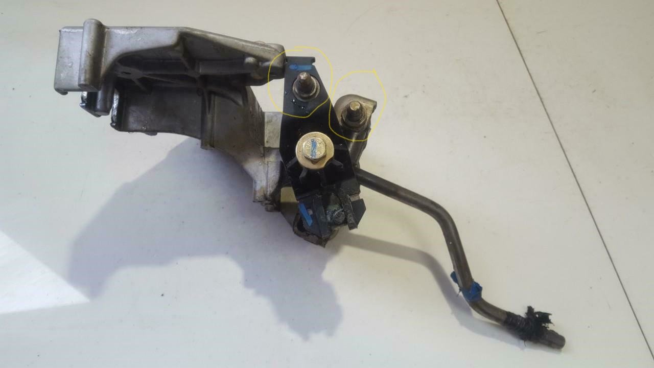

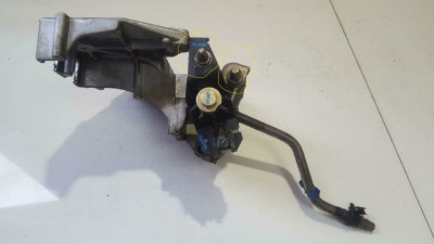

Is it these clips? If its the bits im thinking of the bushes get inserted in the gear cable ends & go over the pins i have circled then the clips secure them onto the pins.
Best post a pic of the bits you have to confirm.

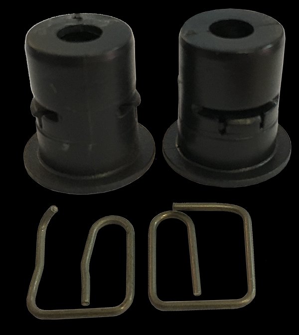

Sorry for not getting back sooner, I have been away. Thank you for the info 'Give me a break'. Yes those are the bushes I ordered wheeler, thanks for the photos. I just been out to the garage and checked the new cables, they already have them installed on the ends. I guess thats another couple of pounds that are going to find their way into the bottom of the spare parts drawer!
