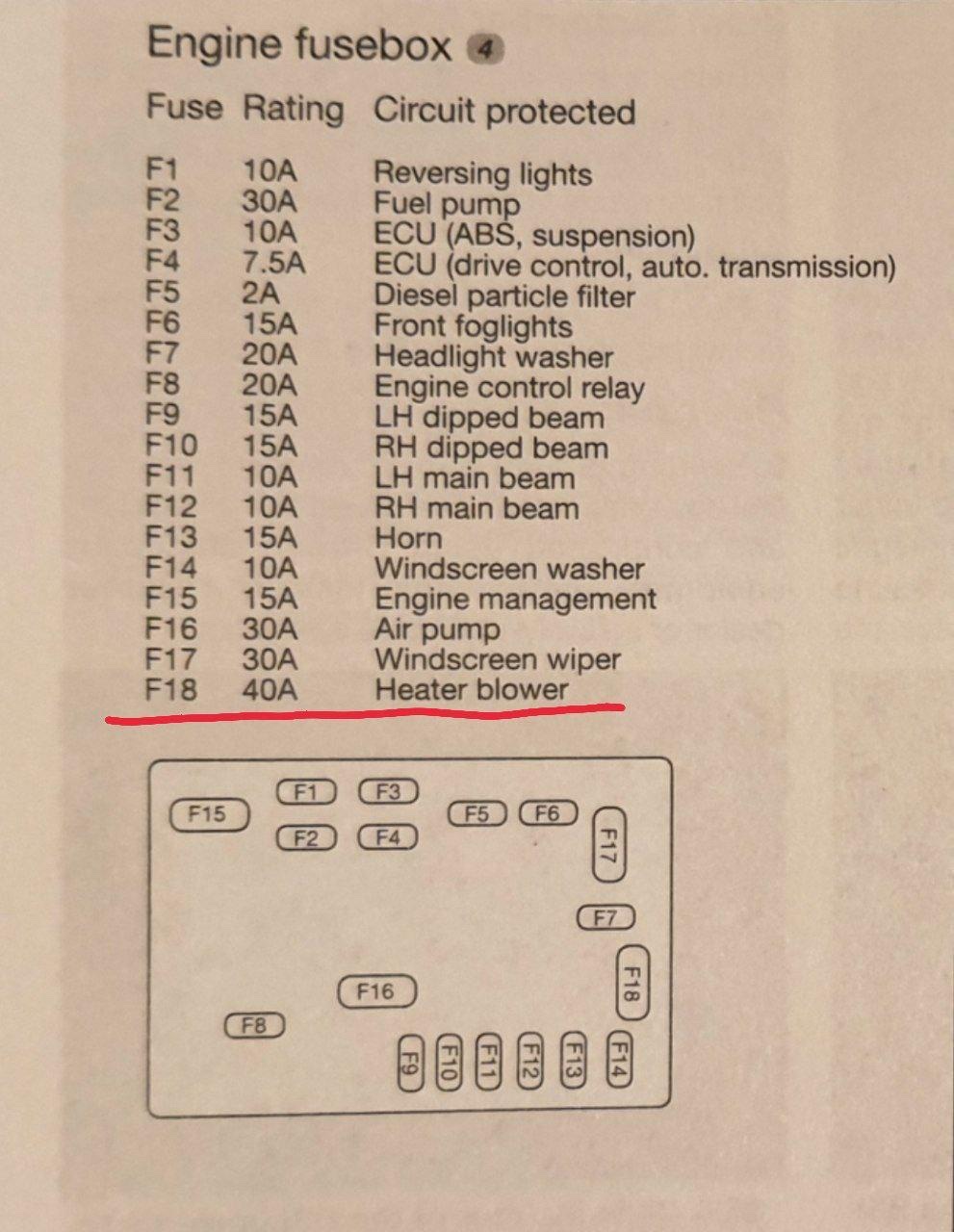

It might also be smart to check the engine bay fusebox blower fuse before taking apart anything else... Last week my blower stopped and I found that the fuse had black contacts and was partially melted (the plastic shell, it didn't actually pop the fuse itself). After cleaning it works well again.
Re: C5 MK II Blower Motor
My previous C5 had this trouble, I bought and fitted a control for it but it wasn't fixed, that turned out to be a melted under bonnet fuse board, resistance in a poor connection causes the fuse to heat up and melt the plastic around it.
