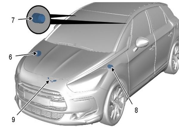

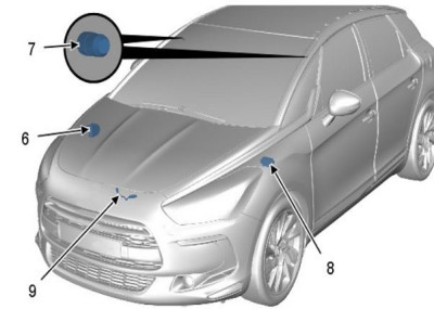

If the alarm warning lamp remains permanently on when you switch on the ignition, this indicates a fault in the alarm system.
All I can tell you is the siren is located somewhere on the front right wing and the ECU is located in the passenger glovebox - probably near the BSI, so be careful there.
(6) is the siren
(8) is the Alarm ECU
As far as the Alarm ECU goes, it does not need VIN coding of course, but here are both country parameters and various sensitivity settings for the Volumetric sensors that need programming according to seat trim, and the sensitivity of the X and Y axis anti lift sensors.

(6) is the siren

Hi Marc, again, thanks for the help. It does look like the siren as opposed to the module in that case as there is no light showing on the alarm disable button.

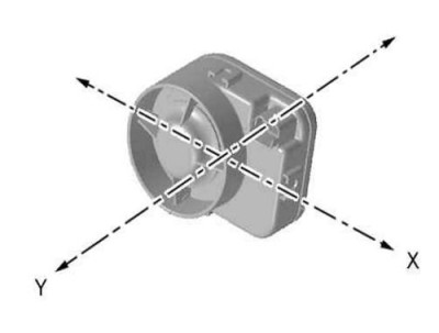

Ok, so that helps. FEE2: Fault on the anti-lift sensor: Not characterised
So the Anti Lift function is incorporated into the Siren unit. So this is the likely suspect and it seems it's not happy about the angle - compared with the reference values. I'd also make sure the wiring to the Siren module is ok and the earth has good contact and that the module has not been moved, knocked or upset during routine maintenance. 'Mechanics' can end up causing more damage if they are a bit clumsy.
"X" Axis of the horizontal plane (Vehicle).
"Y" Axis of the horizontal plane (Vehicle).
The anti-lift protection detects the lifting of the vehicle or of one of its wheels.
The anti-lift function is integrated with the siren.
The anti-lift sensor is active when its output is earthed.
The anti-lift function continuously compares the position of the vehicle on each of the axes X and Y with a reference position.
The siren will be set off in the following instances:
After a failure, if an attempt succeeds, the fault changes to intermittent.
After the activation of the alarm, if the reference angle can no longer be acquired, the anti-lift function is not activated and the fault is maintained.
While the siren is triggered, the measured angle values are not used so that the vibrations of the siren do not interfere with the measurement.
