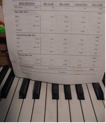

- Posts: 26405
- x 7163
Re: Bargain Basement Motoring
Here's the MOT emissions test results
Def either running lean or there is an air leak into the exhaust, the CO and HC are almost non existant. Are there any running problems? It could be a vac leak D/S of the MAF confusing things. You could do with getting it on a diag machine to see what the O2 sensors are doing and what the fuel trims are. It could be sucking air in at the back box, but they normally leak out there.... What sensors were put in? Cheap aftermarket ones can cause all sorts of mayhem!

Thanks RichardRichardW wrote: 10 Feb 2022, 22:32 Def either running lean or there is an air leak into the exhaust, the CO and HC are almost non existent. Are there any running problems? It could be a vac leak D/S of the MAF confusing things. You could do with getting it on a diag machine to see what the O2 sensors are doing and what the fuel trims are. It could be sucking air in at the back box, but they normally leak out there.... What sensors were put in? Cheap aftermarket ones can cause all sorts of mayhem!
No discernible running problems, plenty enough poke, starts well, idles well after initial start up and temporary fast running from cold, starts fine too when warmed up. Haven't changed the spark plugs for the last 25,000 miles, no misfires/hesitation or anything. Cant be sure which O2 sensors were fitted but no running problems or fault codes cropping up.
I don't think even if you can adjust fuel trims, which I don't have the diagnostic tools to do, it would be worthwhile.
The Cat seems to be doing its job, despite its outward appearance after 18 years so I'll not be throwing a new cat at the problem just yet.
Fingers crossed, I will be heading for the possible exhaust leak, or vacuum leak (although no consequent running problems/starting problems) a bit of injection cleaner, some Esso Synergy Supreme+ 99 Unleaded fuel, and maybe a largely pointless Italian tune up on the way to the test centre for a free retest.
Cant really see how with zero ppm HC (not sure how that happens) and CO well within limits that a marginal excess of oxygen is a problem at all, never mind a failure in a MOT test.
