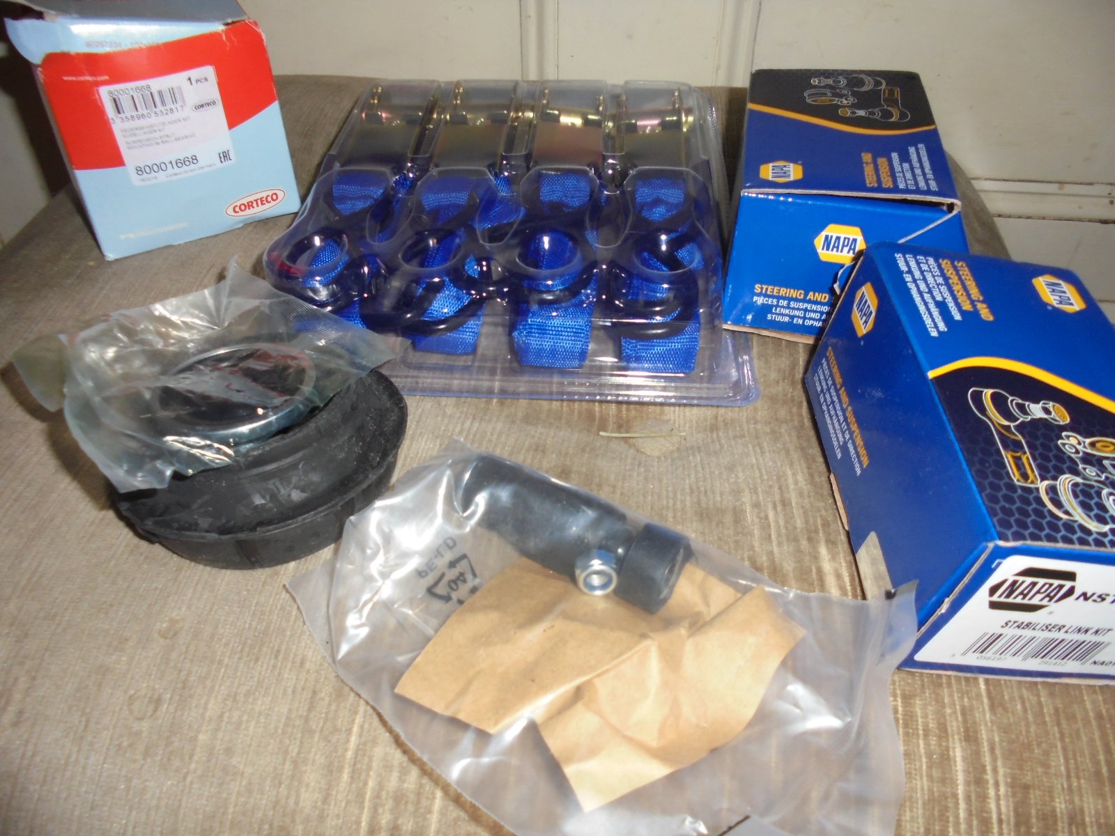

One of the jobs, now where is that T27 Torx bit...depends which one is fitted some are a meatier T40.
Anti Roll Bar Links not much over £5 each. Not your normal drop link on the Clio.
I like Autodoc's videos. Usually give a decent view of what's involved in the job and ther's plenty of them for the Clio 2.

From that video it looks a bit more fiddly than swapping out double ended conventional drop links! Easy enough with a 2 post lift and transmission jack handy but more of a pig on an axle stand methinks. Case of perseverence I'm sure. Good luck!

The major problem, apart from the near zero temperature in the alfresco "workshop", may be a rusted top of the bolt with the torx head, but there does look reasonable access to grind off the nut at the bottom if the nut and bolt won't loosen.

Collection of parts and tools for the mechanical bits. Just over £30 at local factors.
Those ARB links look particularly "light duty". Pleased I could get a new set of spring compressors for £6 ish at Yorkshire Trading.
