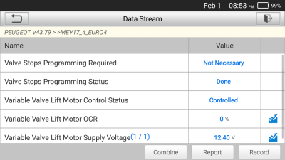

Dannyboy, I used my Launch 123 to see what parameters it had on the variable valve lift assy and found that it was quite happy with my laissez faire approach to not programming the stops for the eccentric shaft
I don't know what OCR means in the above context.
My recollection of the BMW literature is that replacement of the eccentric shaft was done at the behest of the diagnostic software, pretty much the last resort. But it fixed their problem. However, they were not the same engine as ours, and I suspect any excess wear would be in the alloy housing more so than in the much harder steel shaft. There is plenty of scope for wear in the inlet camshaft assembly- I have seen several examples of this. Hard to fathom why this would cause the eccentric shaft to bind but if you could put an ammeter in the supply line to the drive motor it might confirm whether or not you are exceeding the rather high 54 amps mentioned in Marc's diagnostic table?

Hi Gwest, tks for your continued support, I`m running out of ideas. I tried your suggestion of rigging the VVL motor to the centre position. I took the rocker cover off the check it was central. 25 turns from stop to stop.....put it at half way 12.5 turns, looked like it was in the middle. Put the cover back on .....Checked for fault codes: ( they were there before I did this )
