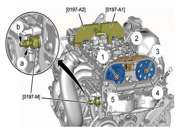

Dephaser - which part is it?

I was just referring to the "dephaser" mentioned in the code description (p0016), not specifically to my car.

Can you indicate the part number for the mentioned dephaser? For the car in questionGiveMeABreak wrote: 07 Sep 2023, 22:23 Ok, so I can't keep up with your vehicles - so you have a garage or something?

But it isn't necessary, just wanted to be sure which part is the phrase refering to (the cam thothed wheel?)

The (1) bolt (Inlet camshaft dephaser (5))
The inlet camshaft dephaser (5)
The bolt (3)(Exhaust camshaft pinion (3))
The exhaust camshaft gear (4)

So what does a 'dephaser' do?

It moves the timing of one camshaft relative to the crankshaft. Some engines have just one on the inlet camshaft, and some engines have one on each camshaft .
