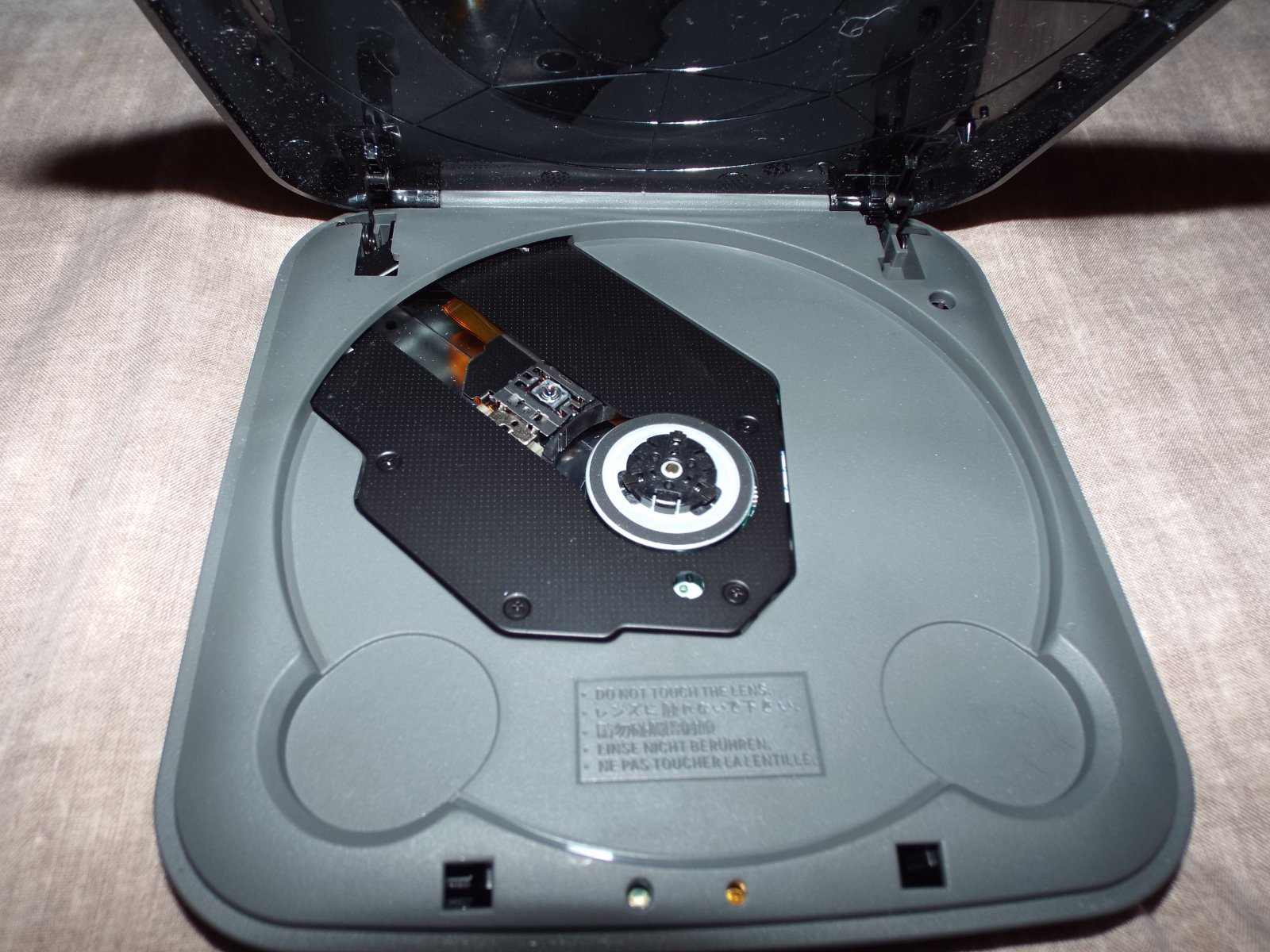

A possible reason for the CD drive not working is dirt on the lens and/or the friction washer. If the drive is the sort that ejects the mechanism take a close look at the lens (it should have an 'oil on water' sheen) and the black washer. I have found that cleaning both can work wonders (the washer with cleaning alcohol, the lens with spectacle cleaning fluid on a cotton bud), but you need to be careful, the lens has a focusing mechanism that could be damaged if too much force is used.
The photo is of my external DVD drive, and shows the friction washer on the drive spindle, and the laser head assembly in the top left area.
