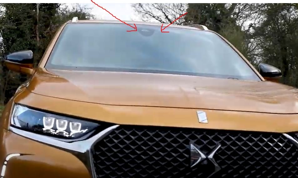

The camera is generally behind the top windscreen:
There are probably a multitude of conditions that need to be just right before adaptive cruise will engage, so if it's not a mucky windscreen and the road is ok, and you're activating it correctly then I hate to say iot but another one on the list for a diagnostic.
