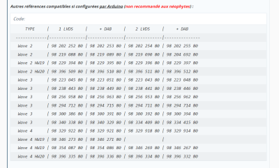

Or you can even fit a newer version: NAC Wave3 (9822305180) or similar (see the attathed NAC SN file) as Wave3 was fitted in the last two years of the production of previous 508.

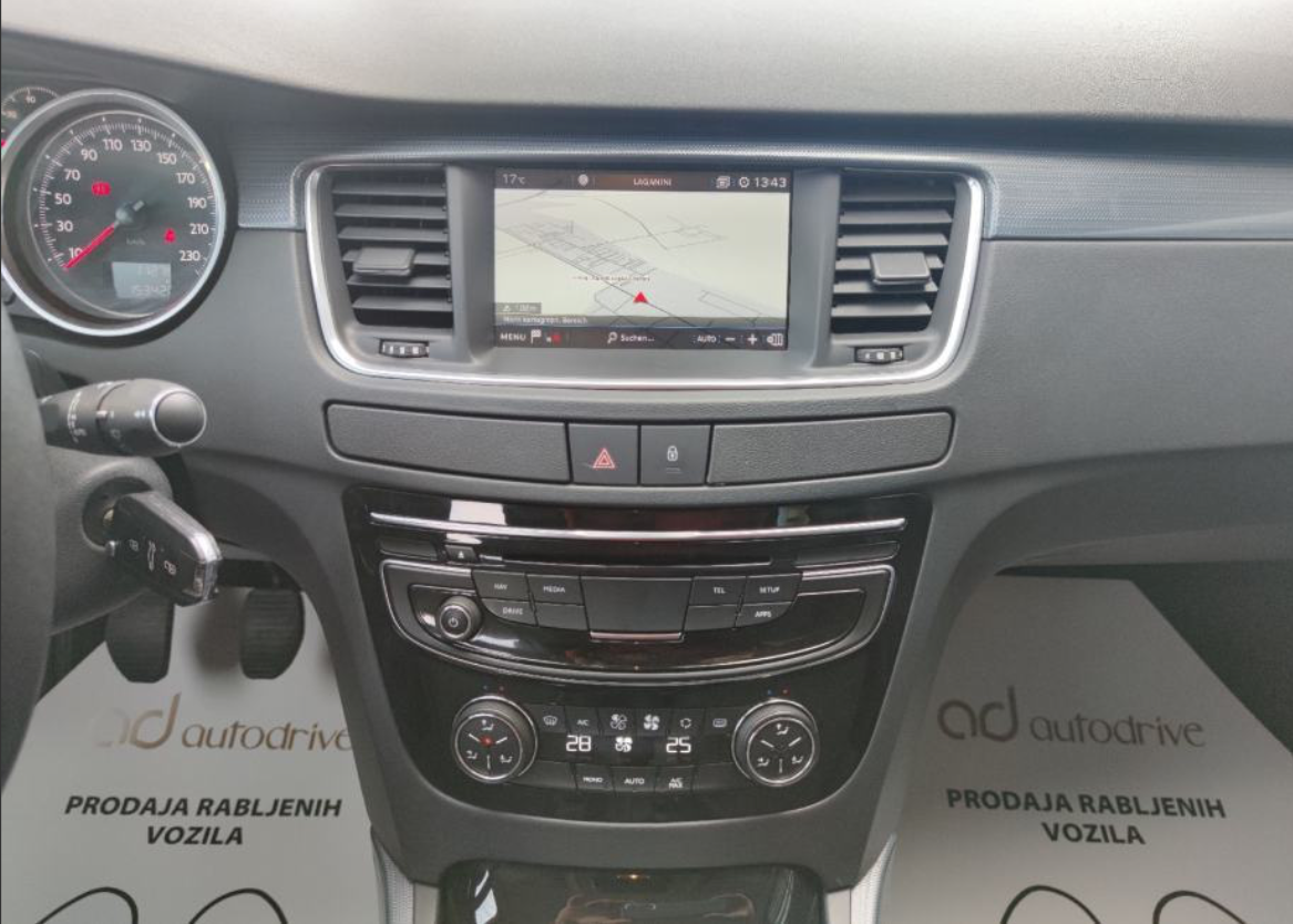

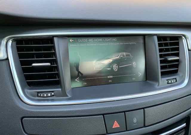

The whole telecoding and testing for my DS5 he did it in his 508, by the way (see the photos bellow). 😎
