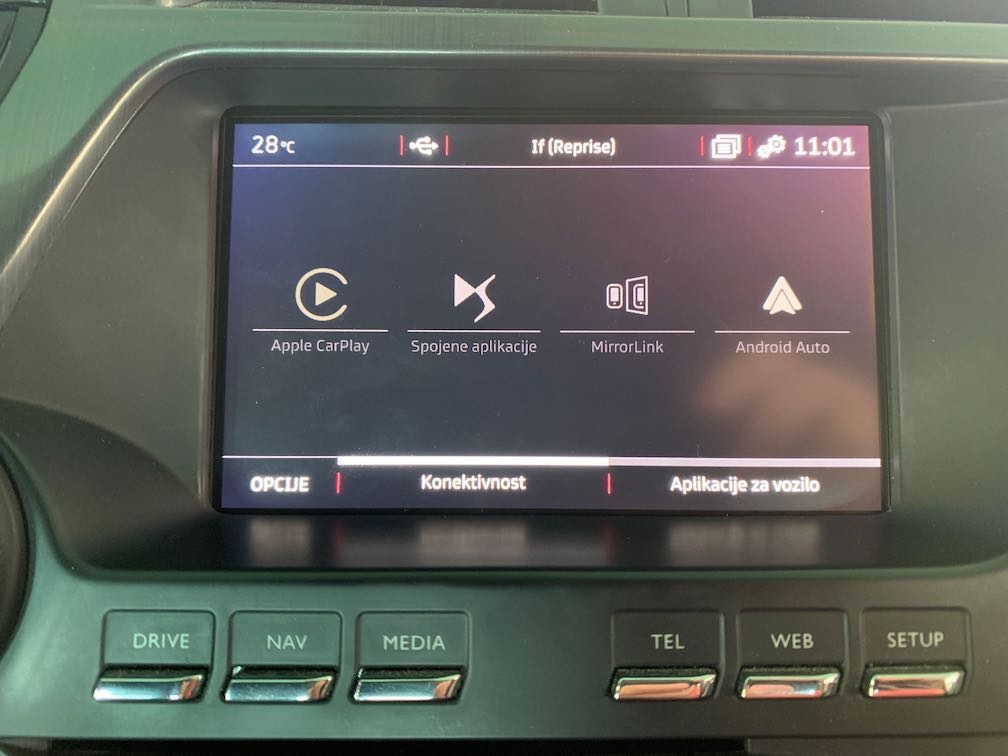

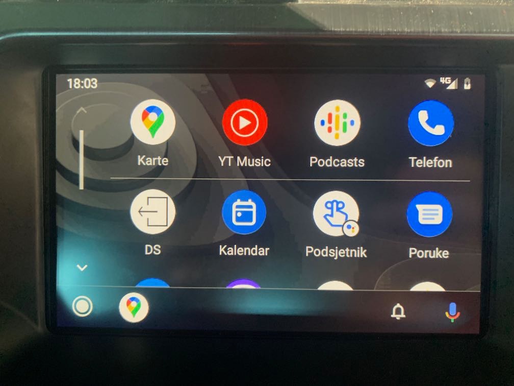

For chcnorris29 or anyone interested:
Good news is the RT6 head unit can be replaced with later NAC Wave2 head unit that was built-in into the latest DS5 series! I personally have swapped my SMEG+IV2 (mid 2015) for NAC (2018) 5 months ago.
What you need is:
a) NAC Wave2: 9821908880 (analog); 9821908980 (DAB+),
b) capacitive 7" touchscreen: Continental EMF DGT7C 9813041280; or multi-touch (3 finger gesture) 9825031680,
c) cable adapters (AliExpress),
d) telecoding your VIN (by seller with Arduino tool or by dealrship and DiagBox) so it doesn't beep at you every second.
Best if you can source it from a written-off DS5 (less hassle for telecoding), but can be sourced from any PSA vehicle equipped with NAC Wave2 (my is from a 2018 P-Expert and screen from a 2018 Toyota Proace). In that case the seller needs to configure the NAC right for your speciffic DS5 with Arduiono tool, and most of them do it (ready for Plug&Play). Make sure you get the VIN from donor car as well.
The whole set can be found on eBay from 400€ onwards. Currently one offered for 410€. Mine was around 440€.
For a prefacelift DS5 you may also want to replace the front radio and heater fascia with the facelift one, as some of the buttons for head unit on later models are different. Or you can leave it as it is - you operate it on the touchscreen anyway. In the same way the knob on the central console becomes obsolete and inactive with NAC.

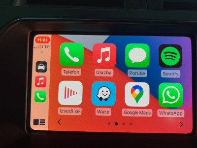

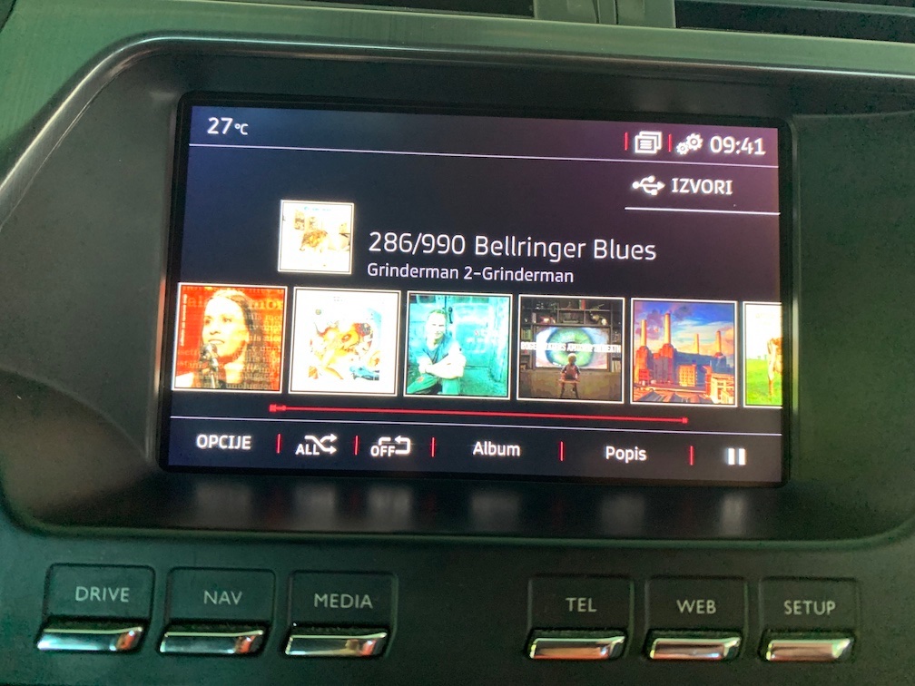

For me it is a well worth upgrade if you want an up-to-date infotainment system, with Tom-Tom 3D maps (updates free for life), voice commands, Connected services (traffic, weather, parking...), 2 USB slots, CarPlay / AndroidAuto and more...
Even myDS app will work!

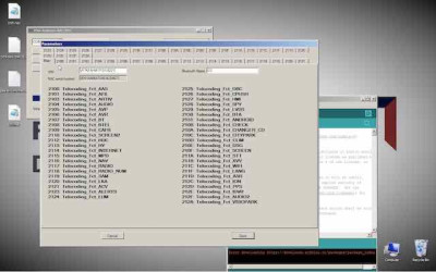

CarPlay and AndrioidAuto nativly supported with NAC.

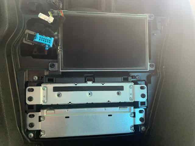

You can swap your RT6 with NAC. If you can get to the RT6 head unit and take it out, then you can fit the NAC yourself.

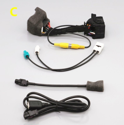

3: Cable adapters from AliExpress (around 30€). RT6 and NAC use different connectors so you'll need adapetrs (in search type RCC NAC cable adapters). If you want to use the both USB ports on your NAC, take cable adapeters option C. Apple CarPlay and AndroidAuto will work nativelly, but only if a smartphone is attathed to original USB port, but you can use the second one for Mp3 stick or anuthing else.

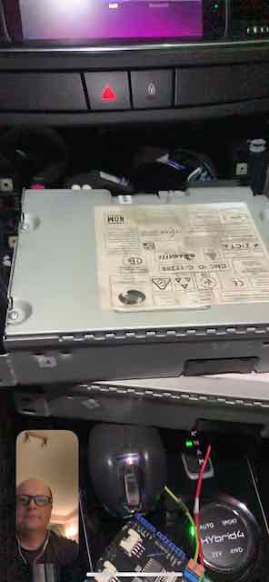

The whole telecoding and testing for my DS5 he did it in his 508, by the way (see the photos bellow).

Cable adapetrs I oredered from AliExpress were the exact thing I needed and they worked right away.

So far I see these seems the most suitable cables. Maybe I will start by purchasing them and figuring out how they will be connected and placed in the car.
https://es.aliexpress.com/item/32951075448.html
I think, first of all, I'm going to start dismounting everything on my car, and see how it goes cable-wise and how everything is attached to the car.
At these point I'm not even sure, how the cables are attached
Also another thing i'm worried is about "debugging". For example, in the screen doesnt work but the NAC does, how I could recognize it?
Re: RT6 to NAC (Connected NAV) Upgrade
Yes, those are correct cables. Option C gives you second USB cable and the price is 30€.
Bera in mind that NAC doesn't have integrated CD reader. I think it's integrated into the RT6, but on SMEG and NAC head unitits it's a separate box. So if you want to play CDs - you'll need that too (see the photo of CD reder + NAC bellow).
The cables are FAKRA type, so they're attached bu Plug&Pin- means you press one pin on the connector and it's free to be unplugged. Easilly.
As for the functionality - you can aske the seller to show you the video of the compete set. It's in his best interest to sell the working equipment. If anything goes wrong - you are eBay protected and ecxept that you can leave negative feedback, should you have negative experience with a speciffic seller...
Again, no reason to worry about.
It's also usefull to watch some videos on replacing the head unit in P508. Always a good idea to learn from someone who's been there and done it...

I have multiple arduino controllers in my house, but not sure to what extent I would be able to do this by myself. Any info regarding this topic?

You may have the Arduino controler yourself, but that's not enough. It needs to be specially designed board with deviation wires to trick the PSA car's BSI - thus allowing the user to configure things as if he were connected to PSA servers with Diagnostic division access level to perform alterations otherwise denied to an authorised dealership (not to mention indie versions of Diagbox owners such as myself).
So the answer to your question is: no, you can't do it alone. Even if you find a NAC 9821908880 / 9821908980 you won't be able to configure it. It's best you buy the NAC (or the whole set) from a seller who can do the necessary telecoding. Most of them can.
Again, if your NAC comes from a latest version of P508 (2016-2018) then it's already configured for your car (buttons are OK just check your equipment level) and it needs only writing in your VIN. But if it comes from say a P2008 or a DS5 then it needs more telecoding. Always with special Arduino tool and calibration file for P508 and your VIN at the end.
The video you linked is a different thing. It's basically adding an electornic box to a SMEG head unit (not possible with RT6) to simulate CarPlay and AndroidAuto functions. That alone is a quite pricy box, not to mention you would need a SMEG head unit, touchscreen display (DGT2) and adapter cables. All together pops up to aroud 700-800€ which makes no sense.
So again, search for a NAC bundle (or at least a configured NAC) from a seller that can telecode it for your car, and you're all set.
