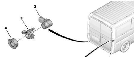

According to your VIN it was fitted at factory with rear parking sensors. So if these have been removed / modified / disabled, as a result of coachbuilding work or body modification, that is likely where you issue is. I suspect the option for the parking assistance system was not disabled in the BSI after removing them. So the BSI may a) be getting a signal from the Parking Assistance ECU saying the sensors are missing, or b) the Parking Assistance ECU has also been butchered / removed without setting the option as not installed in the BSI, so the warning is consistently telling you it can't find anything or it's faulty.
Made of of 4 sensors (2) which you can just see along the lower bottom of the bumper.
