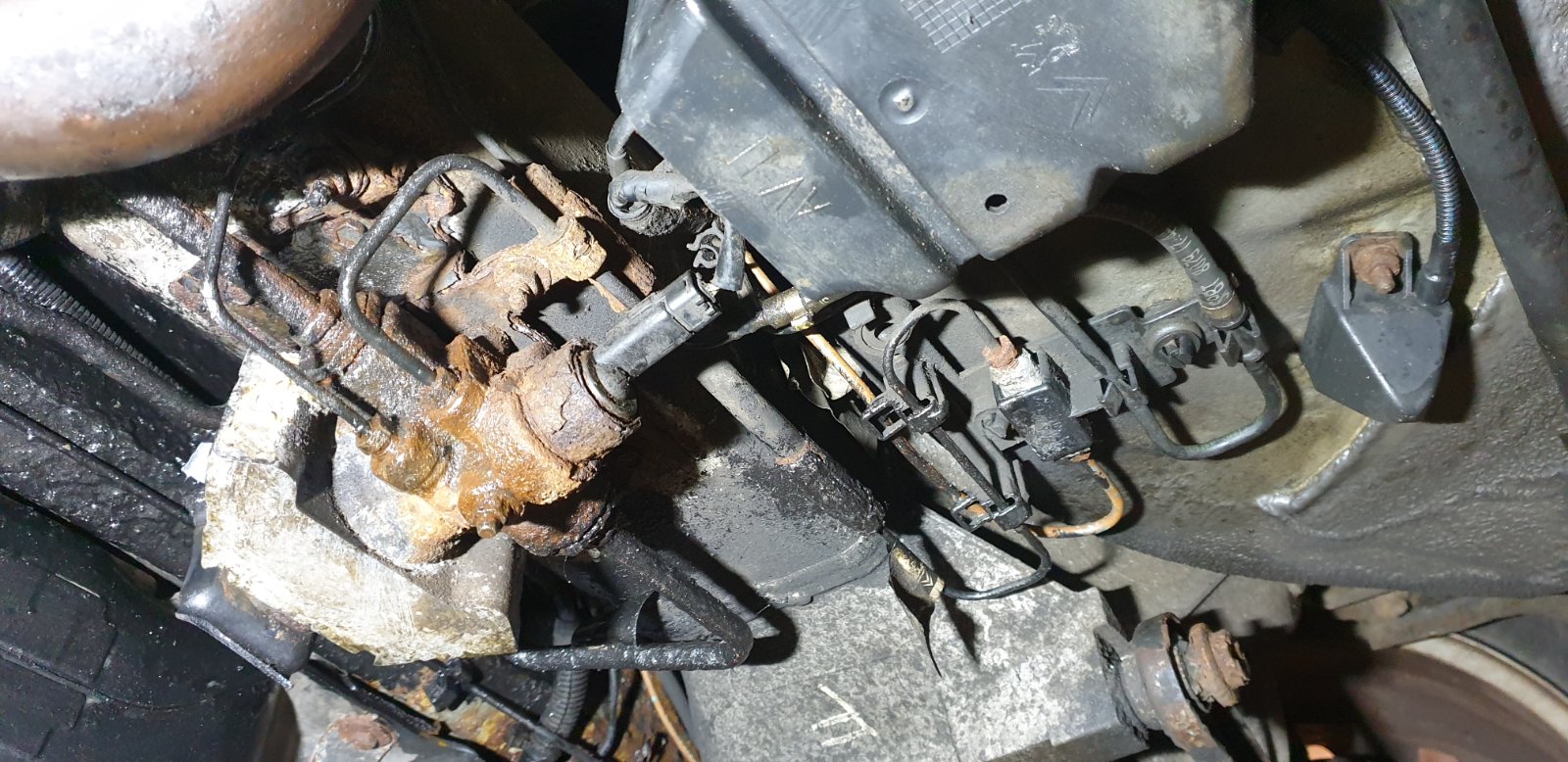

I tested the rear spheres and they're 40 bar each, down a bit from 52 but not severe.. the rear regulator isn't making a sound like the front when fitted are opened... I think the trouble lies elsewhere..

The full rear regulator block is made of rust. I think it was kept at the bottom of the sea. I can't see how the electrovalve is removed from the block and if that's what is not working then I feel the whole block has to be changed. All of the pipes look rusty. Are these pipe union fittings different from the old LHM system fittings?

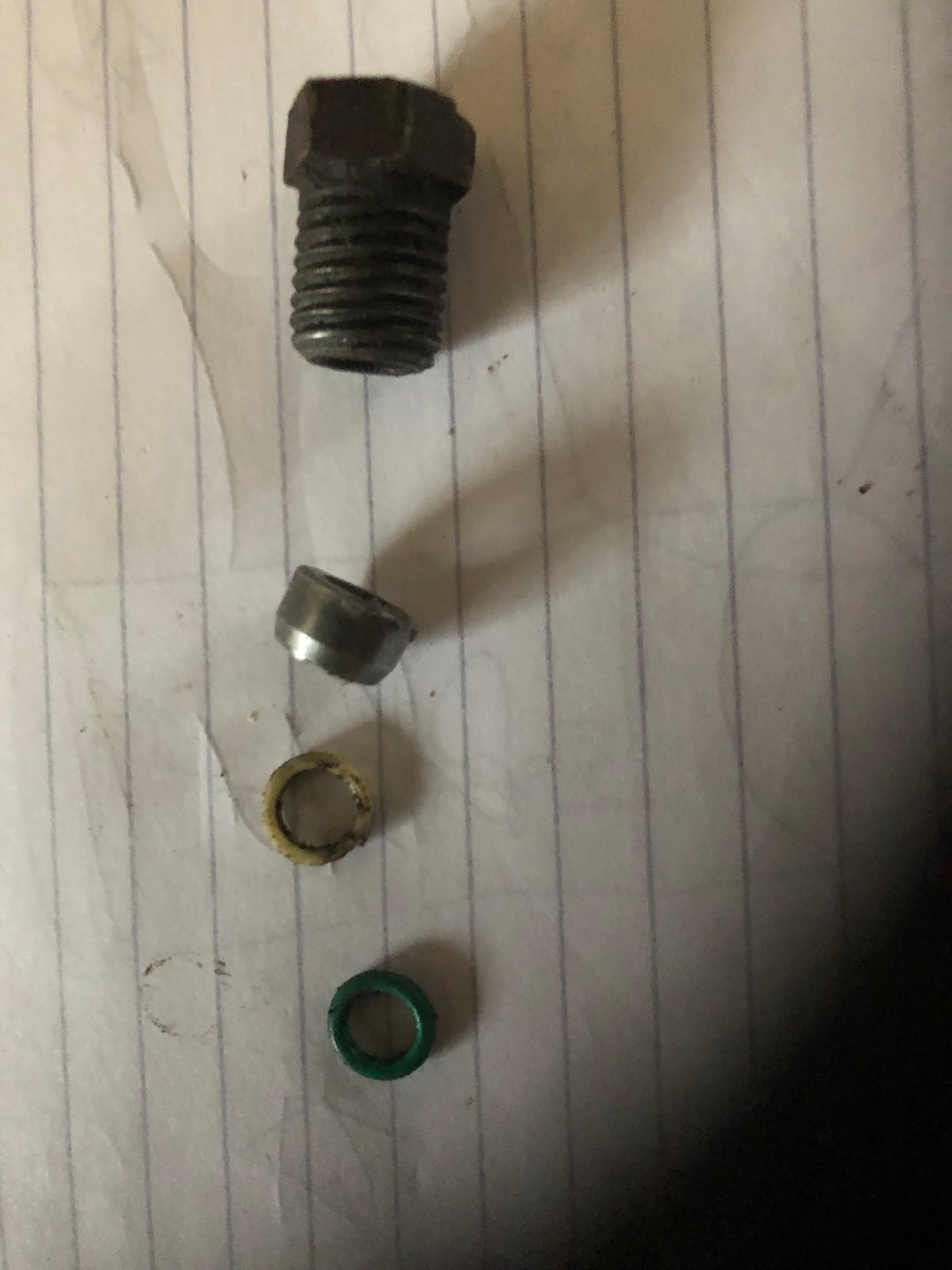

Hi Kenny, just to check - are you saying the small hydraulic pipe unions here are the same as the 3.5 and 4.5 mm Citroen pipe flare as on the Xantia back to the DS? This would be good because I have the flare making tool and I can make up pipes for this.KennyW wrote: 18 Dec 2021, 21:08 Graeme,
Yes they are all the same fitting, I think I have photos of them are on my thread you had a look at.
The new pipe I fitted had an adapter fitted and a standard brake flare fitting unfortunately I don't know what type of flare. But the good news was the pipe I had to remove came off after I gave it a good soaking with penetrating spray.
Kenny

I discovered that the electrovalve solenoid actually does unscrew and I'd actually chance swapping this over instead of the full thing initially - to try and get the rear regulator switching. Does anyone know if this solenoid can be got separately, part no?
It's odd that the diagnostic didn't show this dead electrovalve as a fault. It did show the height sensor as a fault that I cleared and hasn't returned. Perhaps all the scan does is verify the continuity and maybe that was confirmed.

They are NOT the same as the Xantia and older hydraulic citroens, new design and different size.
The pipes are 4.76mm or 3/16" and other sizes.
Kenny
Kenny

Ah! Kenny, I just sent you a PM about this! I missed your post here. Where did you get these fittings? I guess the pipe diameter is different too from the old ways?
