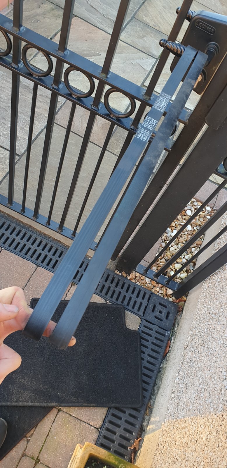

Hm back off again with the auxiliary belt to give it a closer comparison with the old belt before I blame the tensioner and on closer looks the new belt is longer. Ebay supplier but was supposed to be correct for this model
Graeme M
x 6962
Re: New C5 owner with a few questions already
Your original accessories belt is 5750XN with reference (K6 - LE 1217), so length 1217. They are £41.00 from Citroen OEM original or you can get a cheaper Citroen-recommended alternative one (part: 1612163180) for £15.91. I'd never use ebay for these sorts of parts as their databases are invariable useless as you've found out Graeme.

Hiya Marc, yes thanks for the ref numbers. I'll see about getting the right belt.

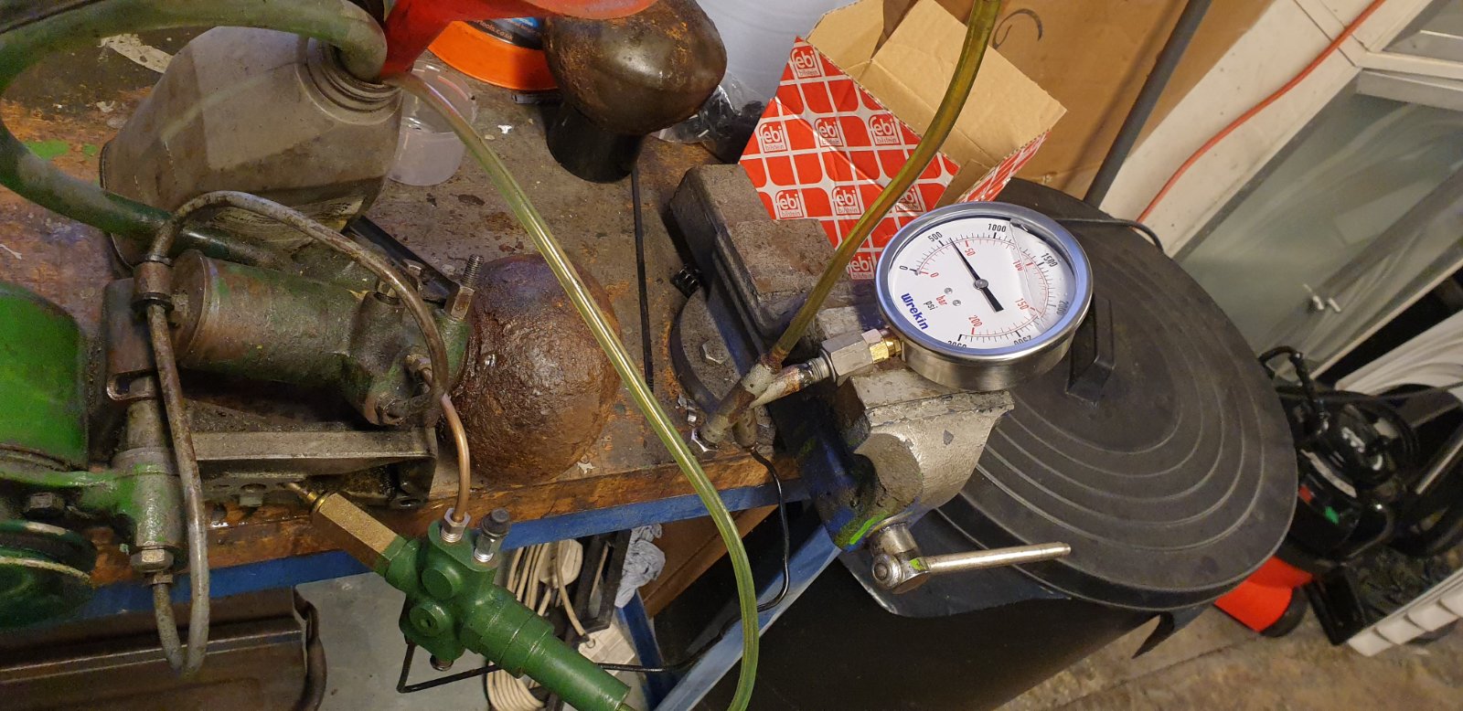

Unread post by aerodynamica »
I tested the rear spheres and they're 40 bar each, down a bit from 52 but not severe.. the rear regulator isn't making a sound like the front when fitted are opened... I think the trouble lies elsewhere..
